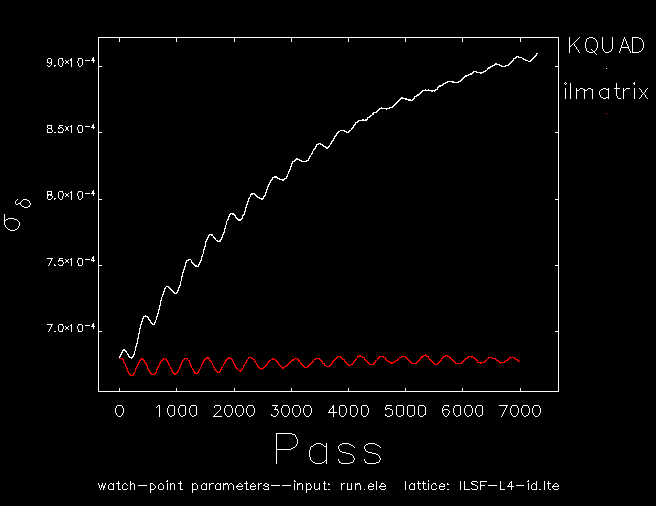

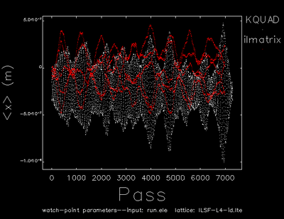

Dear Michael,
Thanks for your recommendation. I built ILMATRIX element for our lattice through the online example provided in the website. For test, I took 7000 turn tracking for both ILMATRIX and (CSBEN,KQUAD & KSEXT). I was supposed to get the same results from both trackings but no similarity appeared, as can be seen in the pictures below:
I was wondering if you could help me to resolve this issue. The lattice is attached.
with many thanks,
Mina
