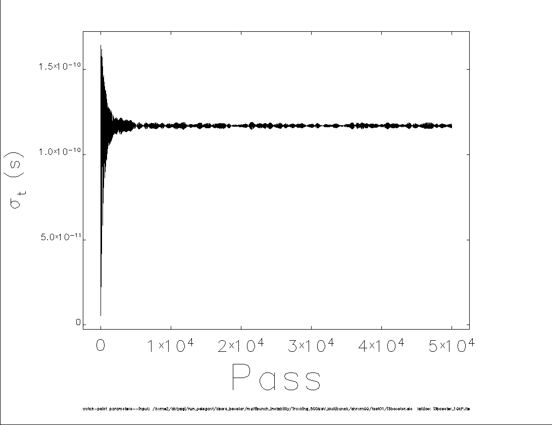

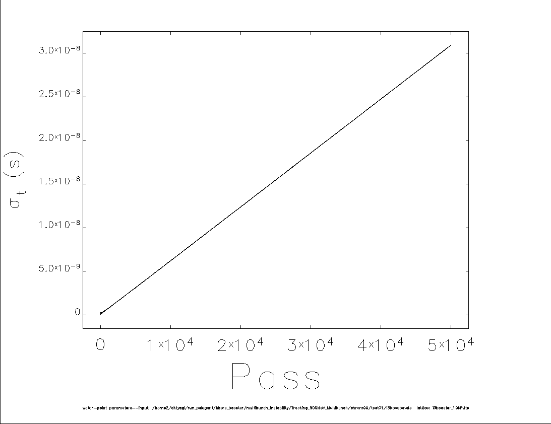

Hi, as per your reply I added RF cavity into the beamline and generate bunch train using RF frequency exactly as in RFCA element even than when I plot "Pass vs st" for first bunch and last bunch the graph are attached.

Re: Multi-bunch Instability Simulations
Some possible sources of the problem:
1. You are not setting the START_PID and END_PID parameters on the WATCH elements correctly, so you are seeing the length computed over several bunches.
2. You have one or more particles outside the rf bucket, so that those particles deviation from the centroid grows quickly.
Most likely #1.
Most likely #1.
