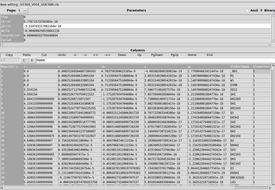

Despite this message, the result that I see in "%s.clo" appears all normal with the found trajectory well fulfilling the periodicity, as well as showing good convergence in the closed orbit search (please see the attachment).
I would therefore like to know whether I can trust the result obtained and whether you see why I get this error message.

I would be suspicious of this result. First, the convergence warning indicates that the normal algorithm had a problem. Second, you have tracking_turns=1, which asks elegant to use a fall-back multi-turn tracking method; however, you only asked it to use 1 turn, which isn't reliable.
It sometimes helps to play with the iteration parameters for &closed_orbit, e.g., try
Code: Select all
iteration_fraction = 0.5
closed_orbit_iterations = 500
I would suspect that your tunes are close to an integer, which can happen when assembling a lattice from GGE elements, since they never match the usual hard-edge elements precisely. To avoid this, we typically tune the STRENGTH parameter on the GGE elements to match the linear matrices of the hard-edge elements, one by one.
