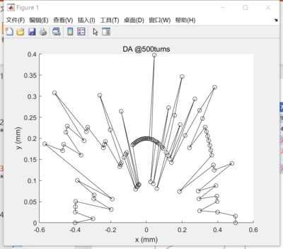

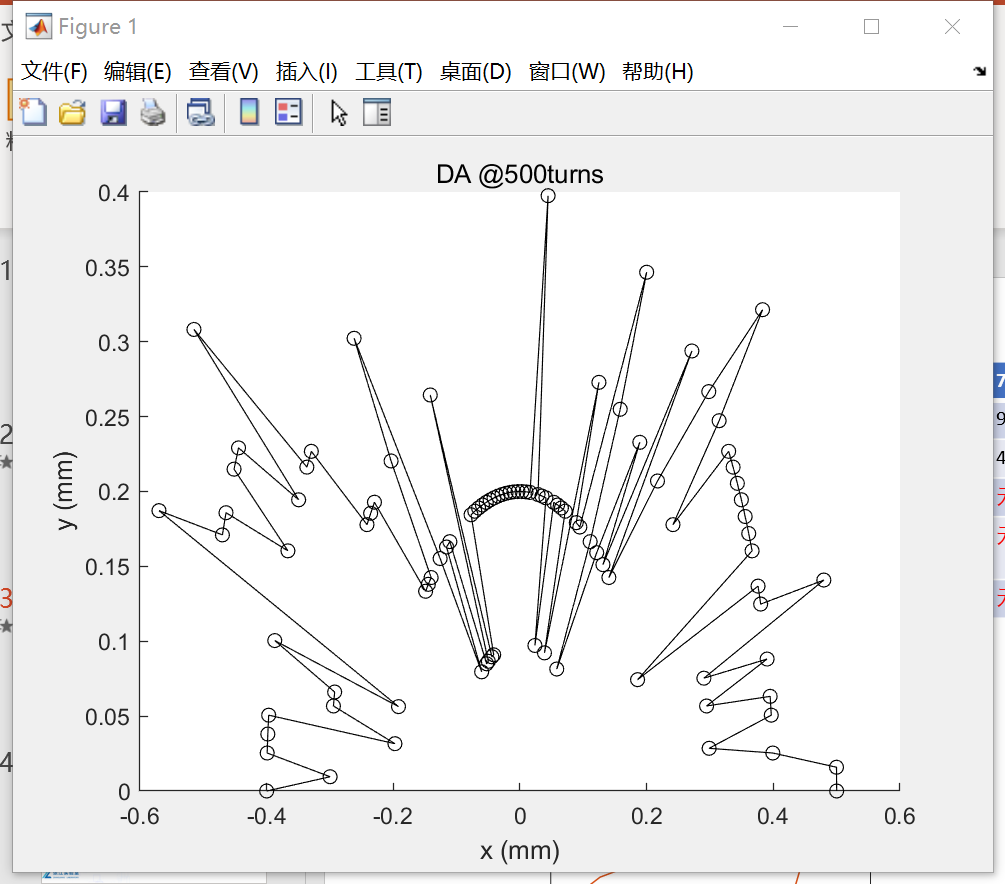

Besides, we have also double checked DA by AT 2.0 (MATLAB version), and finally got DA solutions, as the picture shown. I am wondering why there are different results.weijie wrote: ↑25 Sep 2023, 22:10
However, we have tried to decrease the number of the damping wigglers to 6 super peroid, but the paricle leak quickly also. Maybe the energy spread is still too large. In our second design, we incorporated distributed RF cavities and the dynamic apearture is still zero.
Thank you

Re: Ring tracking with ciwggler element
Dear Michael
The results between AT and elegant are consistent for the ring without a damping wiggler. But when it comes to damping wigglers, elegant will show different results compared with AT. I don't know if there is any error in the damping wiggler design.
