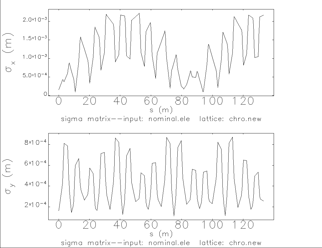

Hello Michael,
I tried to calculate beam size for my ring but variation of the beam size is not small along the ring. Could you please take a look to my files?
Thanks alot and best regards,
Samira
beam size

- Posts: 2062
Re: beam size
Samira,
You need to ensure that you generate a matched beam to start. You have
The beam distribution has no defined beta functions, so some defaults will be used. What you want are the periodic beta functions from twiss_output. You can get the desired result by changing the order of twiss_output and bunched_beam, and adding the use_twiss_command_values=1 parameter to bunched_beam:

Dear Michael,
Now it is working. However when I add some skew quads in my lattice I got the same vertical beam size. What is wrong in your opinion?

- Posts: 2062
Re: beam size
Samira,
I think the problem is partly that your skew quadrupoles are relatively weak. For example, if I multiply the skew strengths by 100, there's a clear effect on Sx and Sy in the .sig file.
Also, please note that &twiss_output does not give trustworthy results in the presence of strong coupling. You can use &coupled_twiss_output instead, as well as &moments_output.
