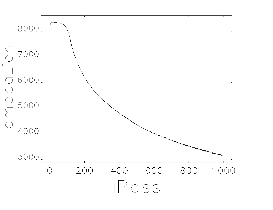

In plotting the ion density with the scripts, it does not plot the ion density since beginning. Please find the figure in the attachment.
I am using the latest version 2021.3.0 . I have checked with fractionional intensities in generating bunch train. It does not give any error but plot of intensity vs bucketnumber shows that it only considers the integer part.

Re: Beam ion interaction using IONEFFECTS element
jcalvey wrote: ↑12 Nov 2021, 13:10Hello Saroj,
This series of commands will plot the average ion density of the APS ring:
sddsprocess ion1.ionDens -pipe=out -process=qIons,last,qLast | sddscollapse -pipe | sddsbreak -pipe=in ion1.ionDens.break -decreaseOf=s
sddsprocess ion1.ionDens.break -process=qLast,sum,qTot -process=Pass,first,iPass
sddsprocess ion1.ionDens.break -define=param,lambda_ion,"qTot e_mks / 1104 /"
sddsplot ion1.ionDens.break -param=iPass,lambda_ion
You should replace the 1104 with the circumference of your ring.
To plot the instability amplitude vs time (as a fraction of vertical beam size):
sddsprocess ion1.ebeam ion1.ebeam.break -redefine=col,ampy,"Cy abs Sy /" -redefine=col,ampx,"Cx abs Sx /"
sddsprocess ion1.ebeam.break -process=ampy,max,ampyMax -redefine=param,iPass,Pass -process=ampx,max,ampxMax \
-process=ampx,rms,ampxRms -process=ampy,rms,ampyRms -process=Sy,rms,SyRms -process=Sx,rms,SxRms
sddsplot ion1.ebeam.break -param=iPass,ampyMax
To plot RMS vertical beam size:
sddsplot ion1.ebeam.break -param=iPass,SyRms
macro_ions is the number of ion macroparticles generated for each ion species, at each IONEFFECTS element, per bunch passage. This will quickly add up to many macroparticles. So the code is always strong-strong.
The start_pid and end_pid are the macroparticle indices that are counted for the bunch. So for 100 macroparticles per bunch, the first bunch has start_pid=1 end_pid=100, the second has start_pid=101 end_pid=200, etc. This is not related to the number of turns tracked.
generateBunchTrain should work with fractional intensities, if you have the latest version. Let me know if this doesn't work.
-Joe

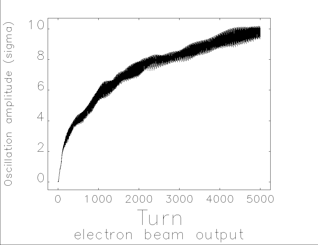

I plot the instability amplitude as per the script you have mentioned in previous reply. The instablity amplitude increases beyond 1 or 2 times beam size, which is not following the theoritical prediction perhaps. Please find the figure of instability amplitude vs turn which shows it increases upto 10 times beam size in vertical plane. Can you please clarify it . Also please answer my previous query on ion denisty plot.
Find the elegant files with which the result was obtained, which may give some clue for the output or where I am doing mistake.
Saroj,
&sdds_beam
input = <rootname>.bun,
track_pages_separately = 0,
use_bunched_mode = 1
&end
The script plots the ion density at the end of each turn. So for your case, it looks like the density is near its maximum after a single turn.In plotting the ion density with the scripts, it does not plot the ion density since beginning. Please find the figure in the attachment.
I've attached a script that will do this, and an example bunch waveform. To use it you need to do the following:
- In makeBunch.ele, set n_particles_per_bunch to the number of particles you want in the highest charge bunch. Note that all beam macroparticles in elegant have the same charge, so the other bunches will have fewer particles.
- Run makeBunch.ele
- cp makeBunch.out <rootname>.bunRef (where <rootname> is your choice)
- Set up a fill file (see attached example). It should have two columns: Index, and WaveformNorm. Index is the bunch index (including empty buckets). WaveformNorm should be 1 for the highest charge bunch, and 0 for empty buckets. For other bunches, WaveformNorm should be the fraction of the bunch charge relative to the highest charge bunch.
- Run the script: makeBunchTrainWF -rootname <rootname> -momentum <energy in GeV> -nBunches <harmonic number> -nPerBunch <number you put in makeBunch.ele> -bunchWF <name of the fill file>
&sdds_beam
&end

Can you please suggest me how to plot the ion density since begining.
Also please comment on my previous query on instability amplitude which was plotted by redifining a column with -redefine=col,ampy,"Cy abs Sy /" . Why in my case, the instability amplitude saturates after reaching 10 times or more of beam size, whereas I think it should saturates in 1 or 2 times beam size as the electric field increases linearly upto beam size and thereafter becomes nonlinear and reduces too.
