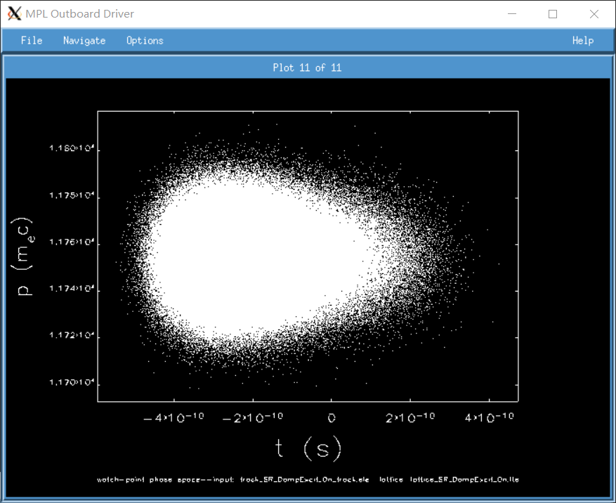

However, when I turn on the radiation damping and quantum excitation in SREEFFECTS by setting 'DAMPING=1,QEXCITATION=1', I didn't get 'flat' distribution after tracking enough turns, as shown in the attached figure. The SREFFECTS was written in the .lte file in the following way:
Code: Select all
SR1: SREFFECTS,include_offsets=0,losses=0,damping=1,qexcitation=1, coupling=0.0
distribution when turning on the damping and excitation

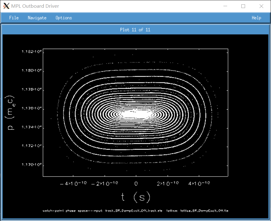

If I turn off the radiation damping and quantum excitation in SREEFFECTS by setting 'DAMPING=0,QEXCITATION=0' (all the other settings were kept unchanged), The 'flat' distribution after tracking enough turns can be seen, as shown in the attached figure. The SREFFECTS was written in the .lte file in the following way:
Code: Select all
SR1: SREFFECTS,include_offsets=0,losses=0,damping=0,qexcitation=0, coupling=0.0
distribution when turning off the damping and excitation
It's very confusing. It seems to me that the radiation damping and quantum excitation introduce extra energy loss, which leading to the distortion of hte bunch distribution in the longitudinal phase space and the shift of the bunch centroid.

Sorry for the delayed reply. Without digging into all the details in your files, I think the reason is that you set all the cavity parameters the same in both cases. However, when you add synchrotron radiation, the phase of the main rf cavity must change. The phase of the harmonic cavity should not change, but its voltage must.
