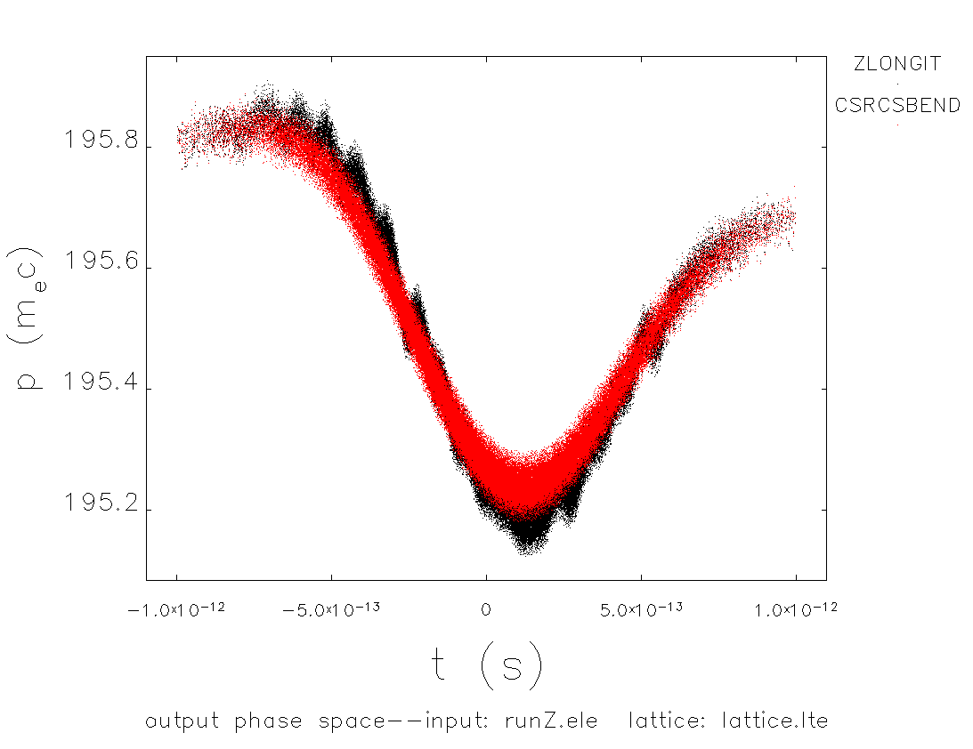

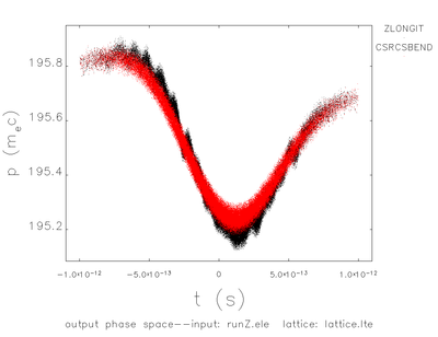

Indeed, I want elegant also calculates the ISR effect on e-beam. So I changed your lattice. I added "CSBEND" to show the effect of ISR and bending field on e-beam, then applied " zlongit" to calculate the effect of the shielding. Please look at following code :
q: charge,total=10e-9
csrz: zlongit,zreal="csrZ.sdds=f+ZReal",zimag="csrZ.sdds=f+ZImag",interpolate=1
b2: CSBEND,l=0.1,angle=0.01,e1=0,e2=0, n_kicks=100, ISR=1
b1: csrcsbend,steady_state=1,l=0.1,angle=0.01,e1=0,e2=0,bins=80,n_kicks=100,sg_halfwidth=4,&
high_frequency_cutoff0=0.2,high_frequency_cutoff1=0.25, ISR=1
blz: line=(q,b2,csrz)
blb: line=(q,b1)
Is it correct ?
Many thanks for any advice,
Best regards,
Najmeh
