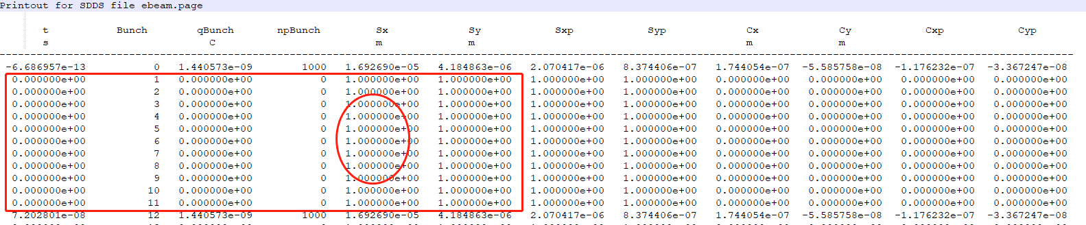

I'm not sure why you are getting any NULL/zero values here. Can you post the exact command you are using for makeBunchTrainWF, and your fill file?tiansk wrote:When I use multi-bunch train beam fillings, the column Sy & Sx in the ebeam file are 1 for NULL bucket, so :

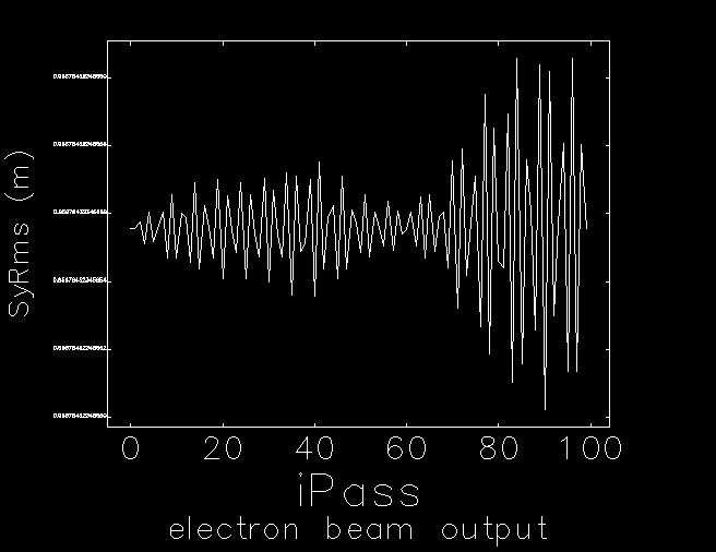

Hi,Joe:jcalvey wrote: ↑09 Dec 2021, 13:53I'm not sure why you are getting any NULL/zero values here. Can you post the exact command you are using for makeBunchTrainWF, and your fill file?tiansk wrote:When I use multi-bunch train beam fillings, the column Sy & Sx in the ebeam file are 1 for NULL bucket, so :
I may not have articulated my problem clearly,my question is that in the eBeam file,the column Sy & Sx in the ebeam are 1[m].so when I used the command:
sddsprocess ion1.ebeam ion1.ebeam.break -redefine=col,ampy,"Cy abs Sy /" -redefine=col,ampx,"Cx abs Sx /"
sddsprocess ion1.ebeam.break -process=ampy,max,ampyMax -redefine=param,iPass,Pass -process=ampx,max,ampxMax \
-process=ampx,rms,ampxRms -process=ampy,rms,ampyRms -process=Sy,rms,SyRms -process=Sx,rms,SxRms
sddsplot ion1.ebeam.break -param=iPass,ampyMax
sddsplot ion1.ebeam.break -param=iPass,SyRms
The image shows the beam reaching a size of nearly 1 [m].
PS:The beam filling pattern mode I just used is:0,12,24,36,......
I've used commands to get rid of unreasonable values: sddsprocess -filter=col,Sx,0,1e-4 ..... like that.

Re: Beam ion interaction using IONEFFECTS element
Tiansk,
Looking through your files, it's not clear to me why train1 and train2 gave different results. If you compare the rms amplitude (ampyRms), does that also look different?
-Joe
-Joe

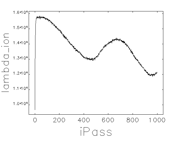

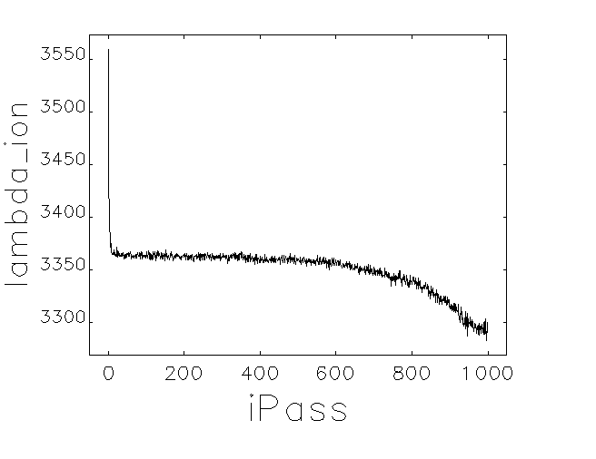

Hi,
I have discovered the same problem for fill patterns with several gaps and I wonder if there might be a bug related to the particleIDs? Previously I created the input beam externally where I just continously increased the particleIDs, but lately I have changed this to skip over particleIDs for empty buckets instead to easier be able to remember which IDs that belong to which filled bucket. If I have understood correctly that is what the new script that comes with Elegant to generate arbitrary fill patterns also does.
I however discovered that I got completely different ion density using the two methods. For the case where I skip over empty buckets they are recorded by ion_effects as having 0 particles, Sx and Sy = 1 and t = 0 and I wonder if this might cause a problem?
Below is the average line density I get for the exact same simulation with the same input beam except the two different methods for assigning particleIDs. The t coordinate is the same for the particles in both cases, so it doesn't feel correct to me to get different results just because of how the particleIDs have been assigned since the fill pattern is exactly the same?
Continous numbering:
Skip empty buckets:
Best regards,
Teresia
Teresia and Tiansk,
Try downloading the script and following the instructions from my post on December 3rd. It works a bit differently than the one you have.
Teresia, I suspect you are correct that it is related to the particleID.
-Joe
-Joe
