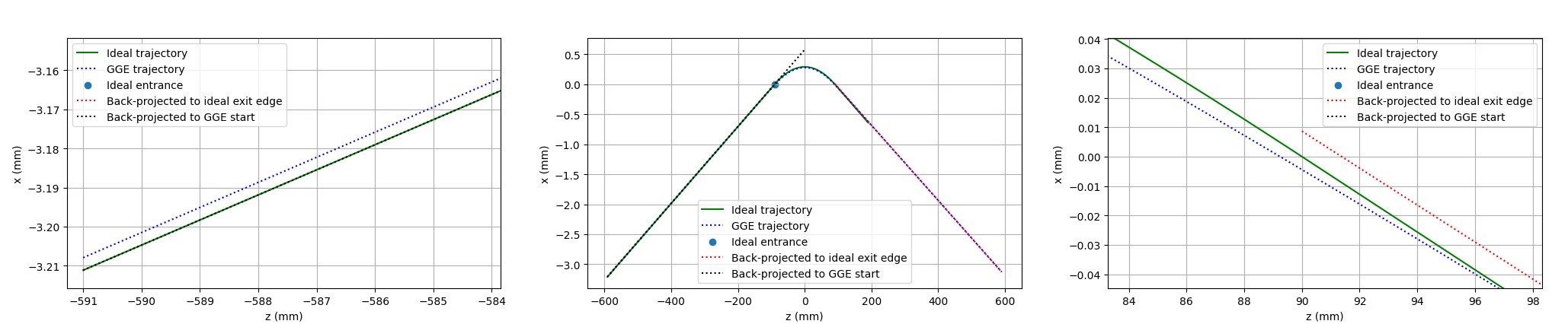

1.
According to my understanding, the tracking process in BGGEXP is:
1) project particles from the ideal entrance edge to the start of the GGE field (as a drift);
2) track particles through the GGE field;
3) project particles from the end of the GGE field to the ideal exit edge.
However, the start of the trajectory output from the BGGEXP element is not consistent with the ideal trajectory.
The deviation at the ideal exit edge is also not consistent with Δx in the zero-order transfer map.
Attached is a comparison of trajectories for a rectangular bending magnet.
mpr data: C: 1.180117e-05 1.312073e-04 0.000000e+00 0.000000e+00 1.800011e-01 0.000000e+00
