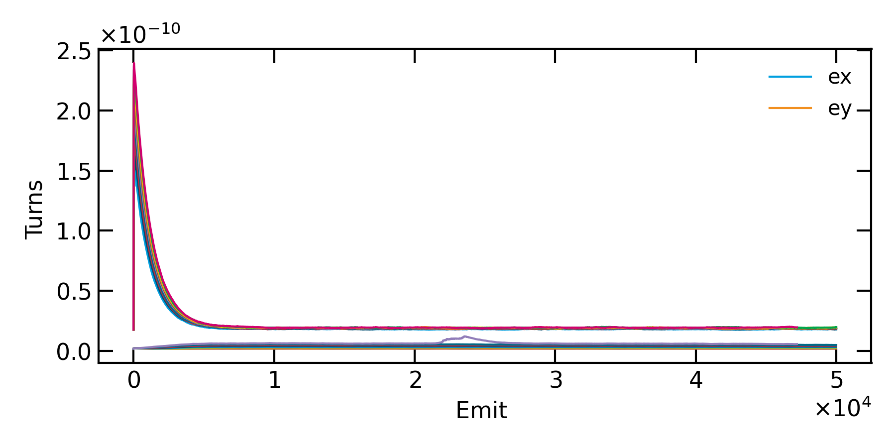

Meanwhile, I did a simple scan on beam current from 0.1 mA to 1mA, the results is shown below
There are two groups of curves, each including 10 (0.1 mA to 1 mA with a 0.1 mA scan step).
The group with an initial growth corresponds to x-plane.
Even in 0.1 mA beam current, there exits initial emittance growth in the x plane
It seems like the initial emittance growth comes from somewhere else rather than the space-charge kicks.
Could you please confirm this and help me figure out where it comes from?

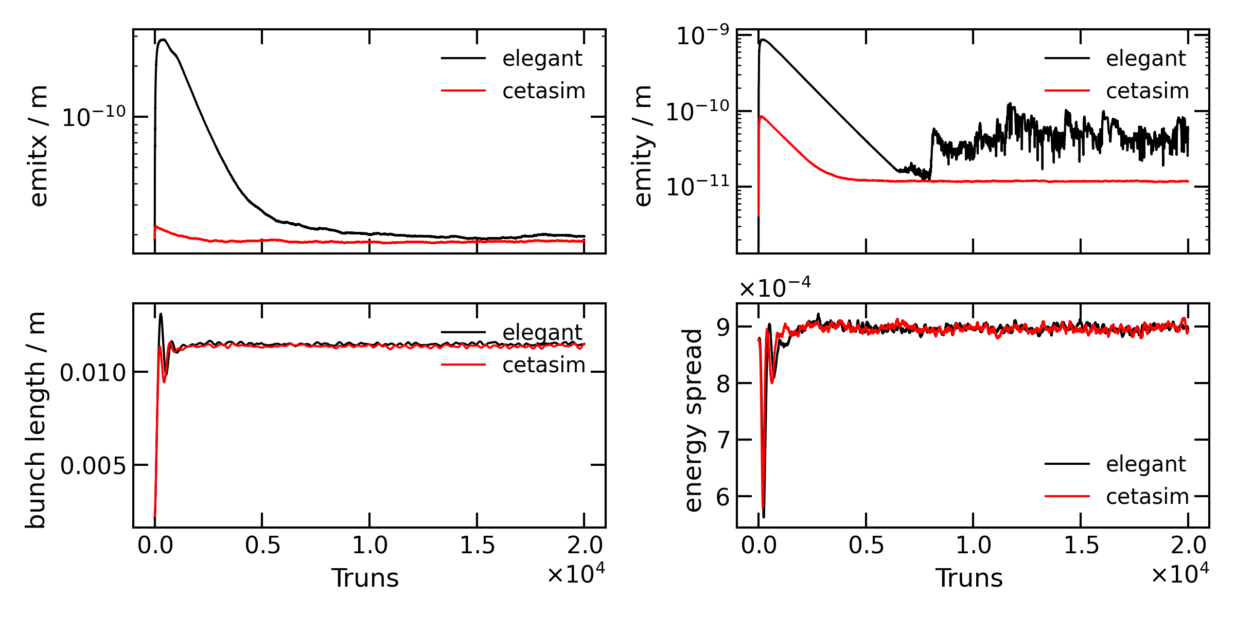

To gain a better understanding of the results that include space charge, I performed an additional benchmarking simulation. For this purpose, I used an unphysical one-turn linear ILMatrix to represent the lattice. The Elegant setup file is attached for your reference. In this simulation, both radiation damping and excitation are included.
The figure below shows a comparison between Elegant and my code. In our space-charge solver, the kicks are computed using a bin-based method: the bunch is longitudinally divided into many bins, and within each bin the Bassetti–Erskine formula is used to compute the transverse space-charge kick for each particle.

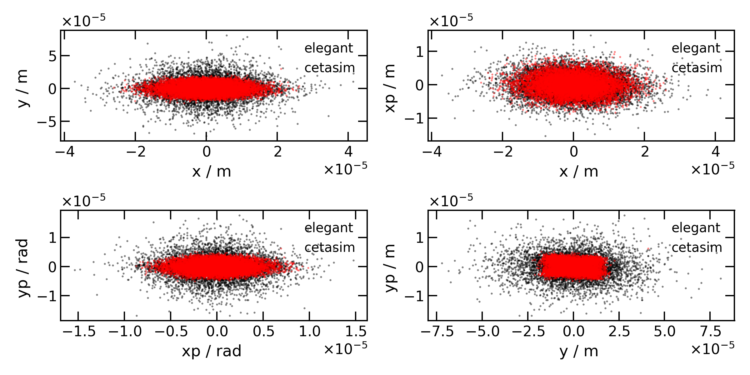

As you can see, in the vertical plane around 5k turns, the tracking shows an emittance increase with a “noise-like” pattern caused by halo particles. The particle distribution at 5k turns is shown below:
These halo particles persist, or regenerated, in the subsequent turns.
Could you please take a moment to check this behavior again? I am trying to understand why, in my simulation, halo-induced emittance noise appears around 5k turns, and why—given that my lattice is essentially a linear map—these halo particles are not damped out in later turns.

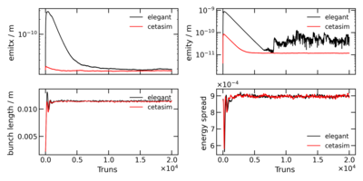

Re: space charge simulation in rings
Post by michael_borland » 14 Nov 2025, 11:09
Chao,

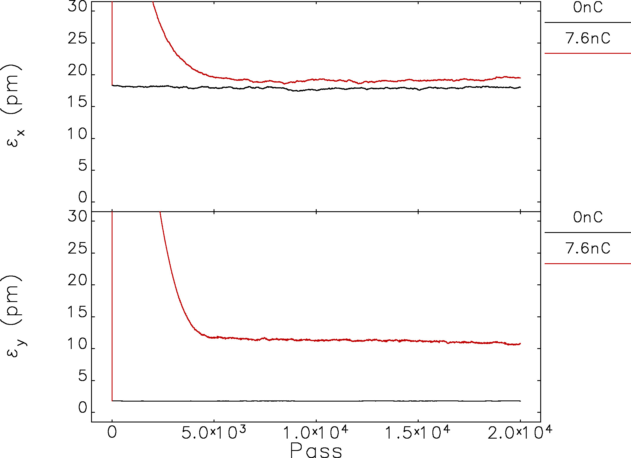

Here's what I get. No sign of the "noisy" behavior. I think this was a result of the above-mentioned bug in the older versions of the code.

This plot compares results with and without space charge, using 1ps longitudinal slices. Seems that space charge has a significant impact on the vertical plane.
Since the runs don't take much time, I increased the number of particles to 10 million, but it's excessive.

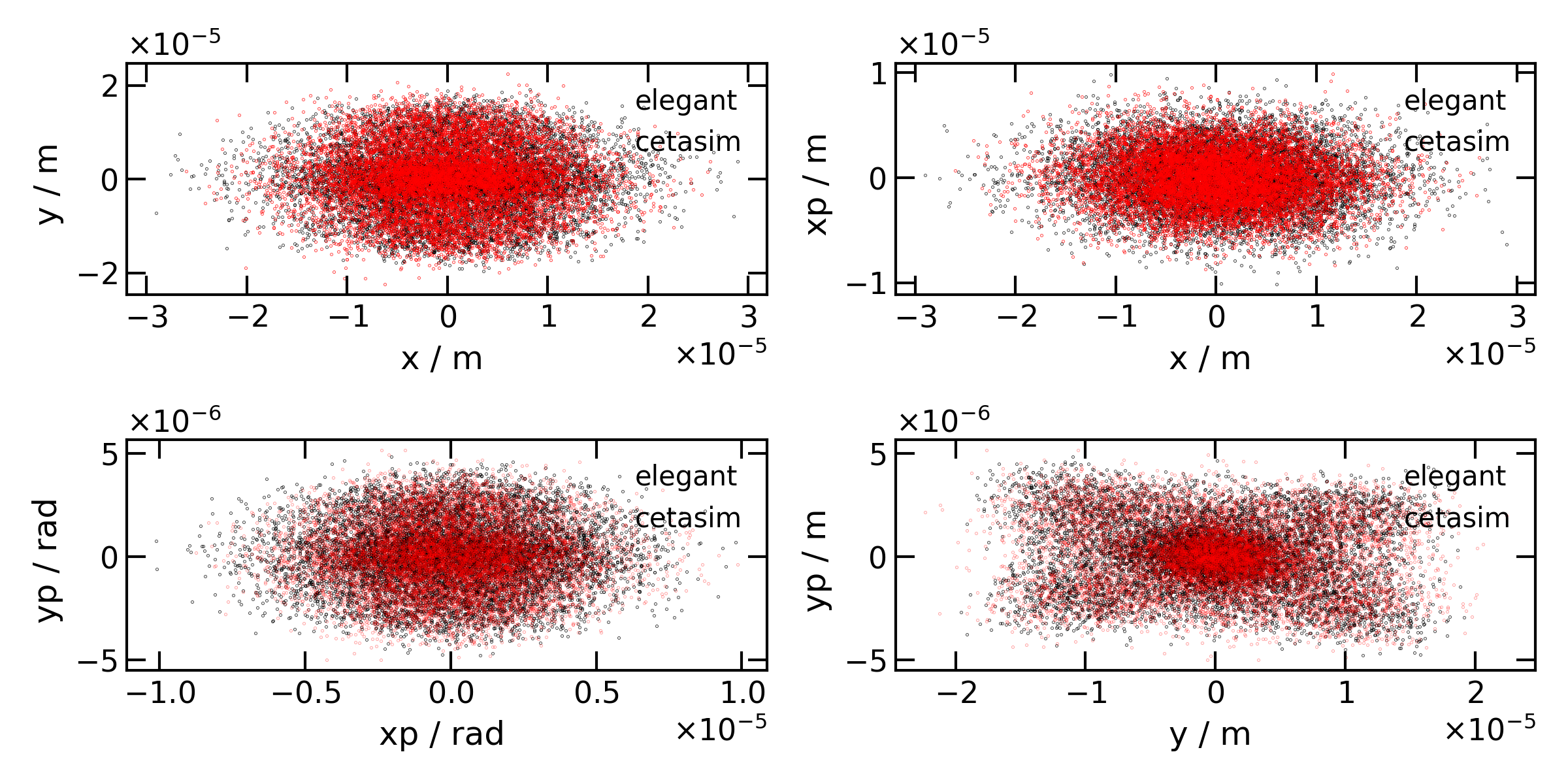

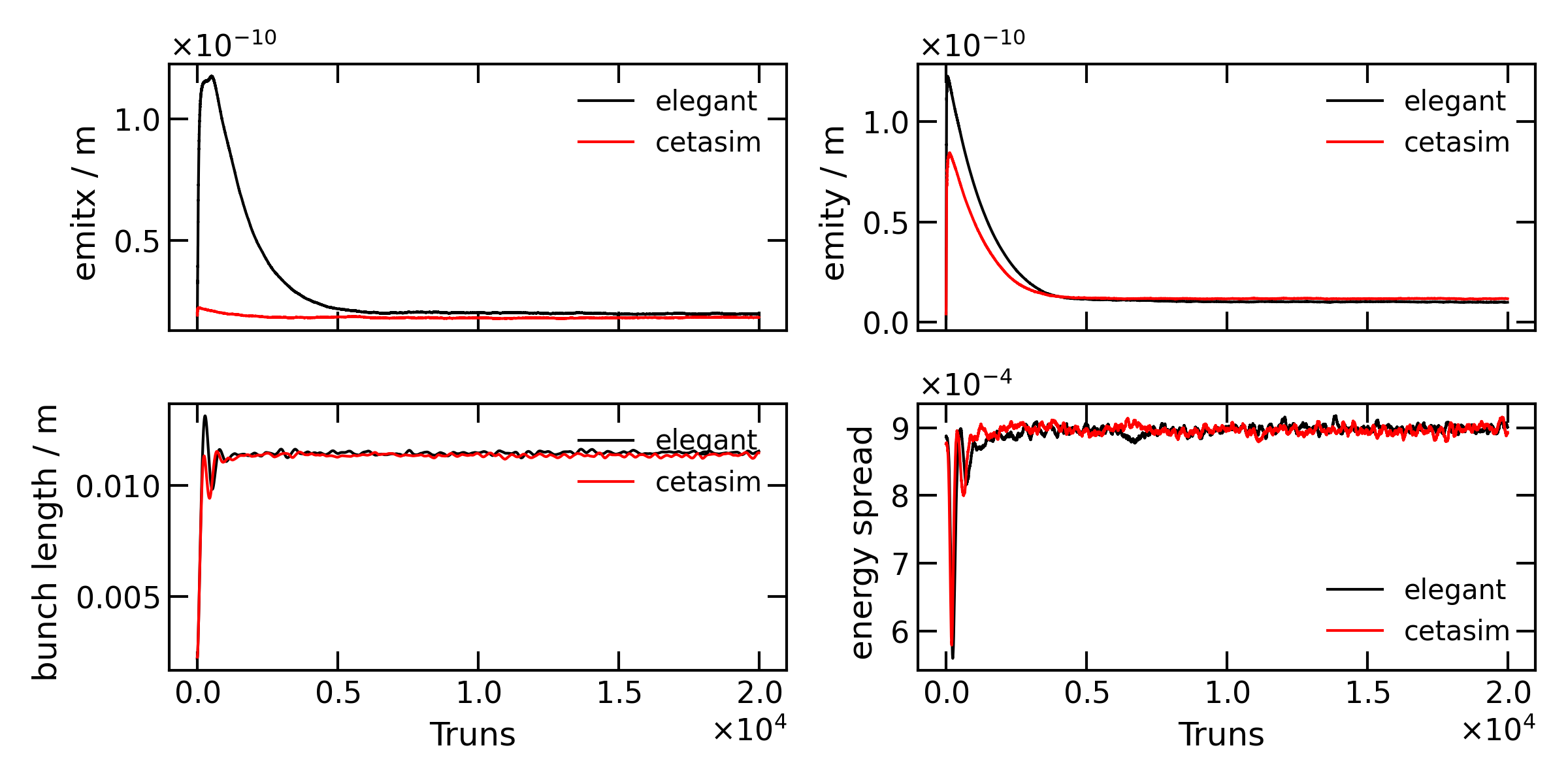

I have checked the results from the new version of elegant, the results are shown here
particle coordinates at the 5K turn.
After enough damping time, these two solvers show good agreement. Although there still exist discrepancies in the emittance curve in the first 1K turns, especially in the horizontal plane. I guess this could be from bin method applied in my space charge solver and "nonlinear" method applied in Elegnat. Do you agree ?
