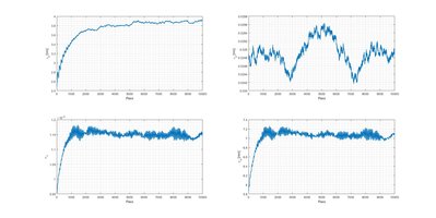

Dear all,
The attached file is the result of particle tracking with IBSCATTER and SREFFECTS(COUPLING=0.01),the emittance of y direction is not growing so much! If using the ibsEmittance command,the final emittance_y/emittance_x will be equal with the coupling factor.Should I add some tilt bends or quads in the lattice?
Thanks in advance!
Tiansk

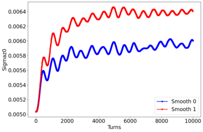

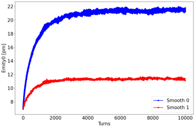

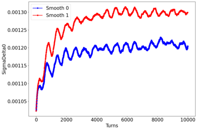

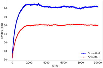

Dear all:
When using IBSCATTER to simulate the IBS effect, there is a parameter called SMOOTH in IBSCATTER. I believe that setting SMOOTH to 1 or 0 may result in different paths for the variation of beam parameters, but the final equilibrium state should be relatively consistent. However, after comparing the results with different SMOOTH settings, I found that the beam equilibrium state parameters differ significantly, as shown in the attached files. How can this be explained?
Thank you in advance,
Tiansk
Tiansk
Re: intrabeam scattering with IBSCATTER
The change in the vertical emittance is shown in the figure below.
