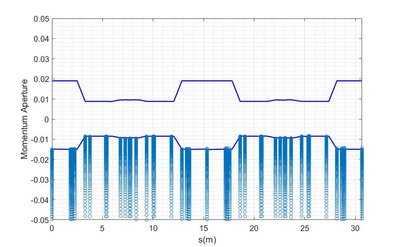

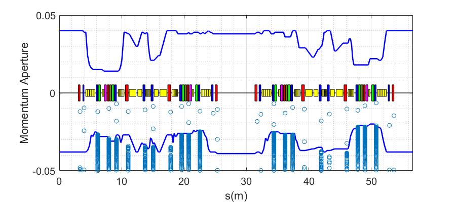

Dear Michael,
I run the example files that you upload I got the deltaLost and LMA file,I plot the LMA and deltaLost in a picture,they matched well. But I run the my files,the deltaLost and LMA didn't match so well,there are some small datas I got,shown in the picture.I think the min(abs(deltaLost))will be used in the lifetime calculation,so I'm using this data to get the lifetime is reliable?
tiansk
tiansk

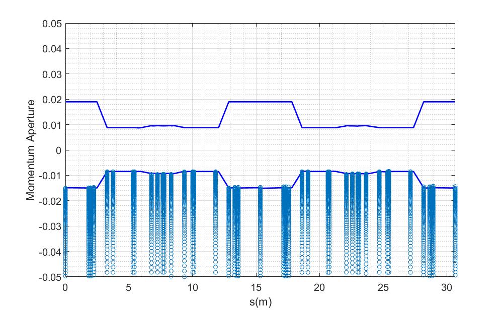

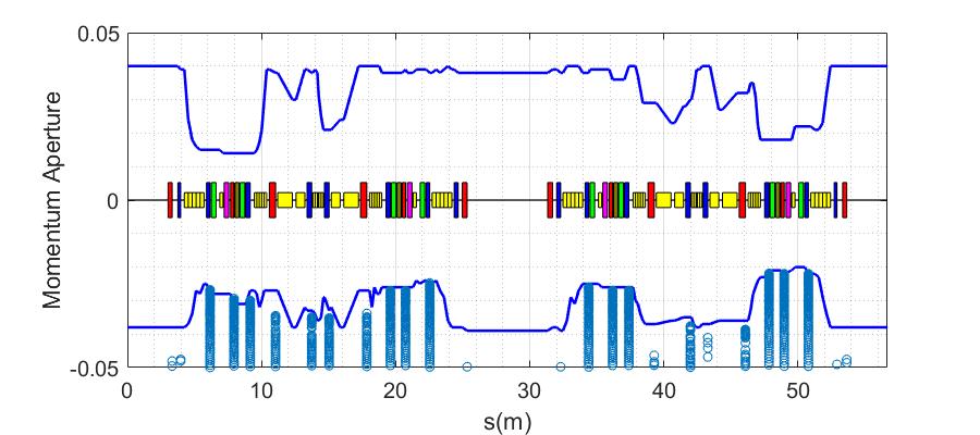

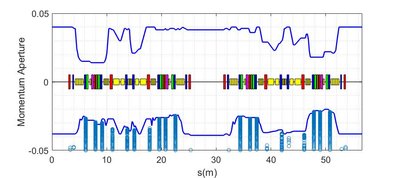

Re: Gas Scattering lifetime
Dear Michael,
if I set the s_end = 56.683333334200107,when I only track one cell,I get the deltaLost VS. LMA is well.
Dear Michael,
I'm sorry,I write the column name wrong,it‘s not deltaLost column ,but the delta column. I used the delta column data to get the picture!
tiansk
tiansk
