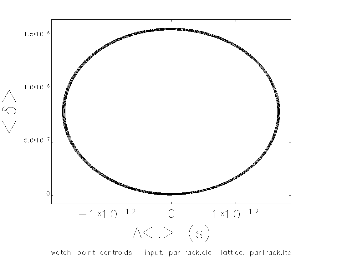

If I run the PAR/synchrotronTune example, unchanged, I get the following motion in longitudinal phase space:
There is a momentum offset on the fixed point as well (it is quite small in the example, but still significant). The example uses radiation damping and rf_setup, so surely the rf frequency is correct? I have also tried slightly changing the RF frequency for my case, but any deviation just causes the phase space ellipse to slowly drift away in time). (Incidentally, I also obtained the frequency value I use from a tracking run with rf_setup.)

Those small momentum offsets result from small errors in the path length, which is an issue with the symplectic integrator for dipole magnets (e.g., CSBEND, CSRCSBEND). There are three solutions to this. First, you can increase the number of slices (N_SLICES parameter) and use the 6th-order integrator (INTEGRATION_ORDER=6). Second, you can set REFERENCE_CORRECTION=1, which will compensate not only for the path-length error but also small (x, x') errors. Finally, you can adjust the rf frequency based on a measurement of the time of flight of a reference particle, after carefully setting it up so the reference particle starts on the closed orbit; in some ways, this is best because it will allow you to account for synchrotron radiation effects, but it takes more work.
