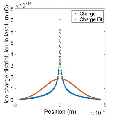

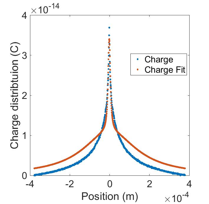

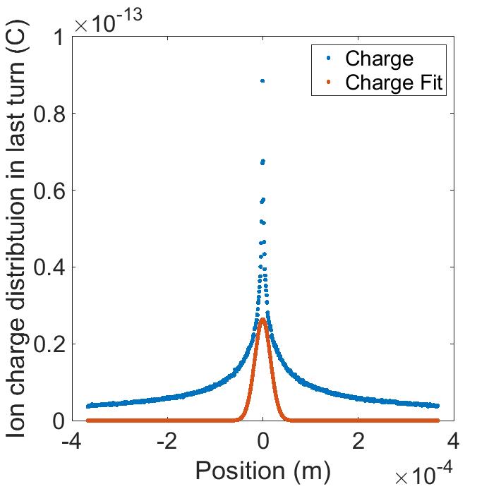

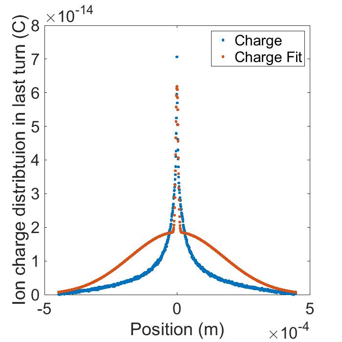

Hi Joe,
It seems for my case, the bi-lorentzian fit gives a result that looks a little better than bi-gaussian. The charge distribution looks more like a concave curve but the bigaussian gives a more convex curve. And the gaussian fit feels underestimated the charge distribution.
Here are the three examples of the fitted charge distribution.
The Gaussian fit The bi-Gaussian fit The bi-Lorentzian fit
I tried one case with both methods. Up to now, the bi-Lorentzian method has a similar speed as the bi-gaussian method and the ion-effects from bi-gaussian method seems a little stronger than that of the bi-Lorentzian method.
Best regards,
Siwei

Re: bigaussian method in ion-effects
Hi Siwei,
Interesting results!
The "gaussian" option doesn't actually do a fit, it just uses the total charge and sigma within a certain range of the beam centroid. You can increase this range by increasing the gaussian_ion_range parameter. You could also try the "gaussianfit" option, which tries to fit the whole distribution with a single Gaussian.
