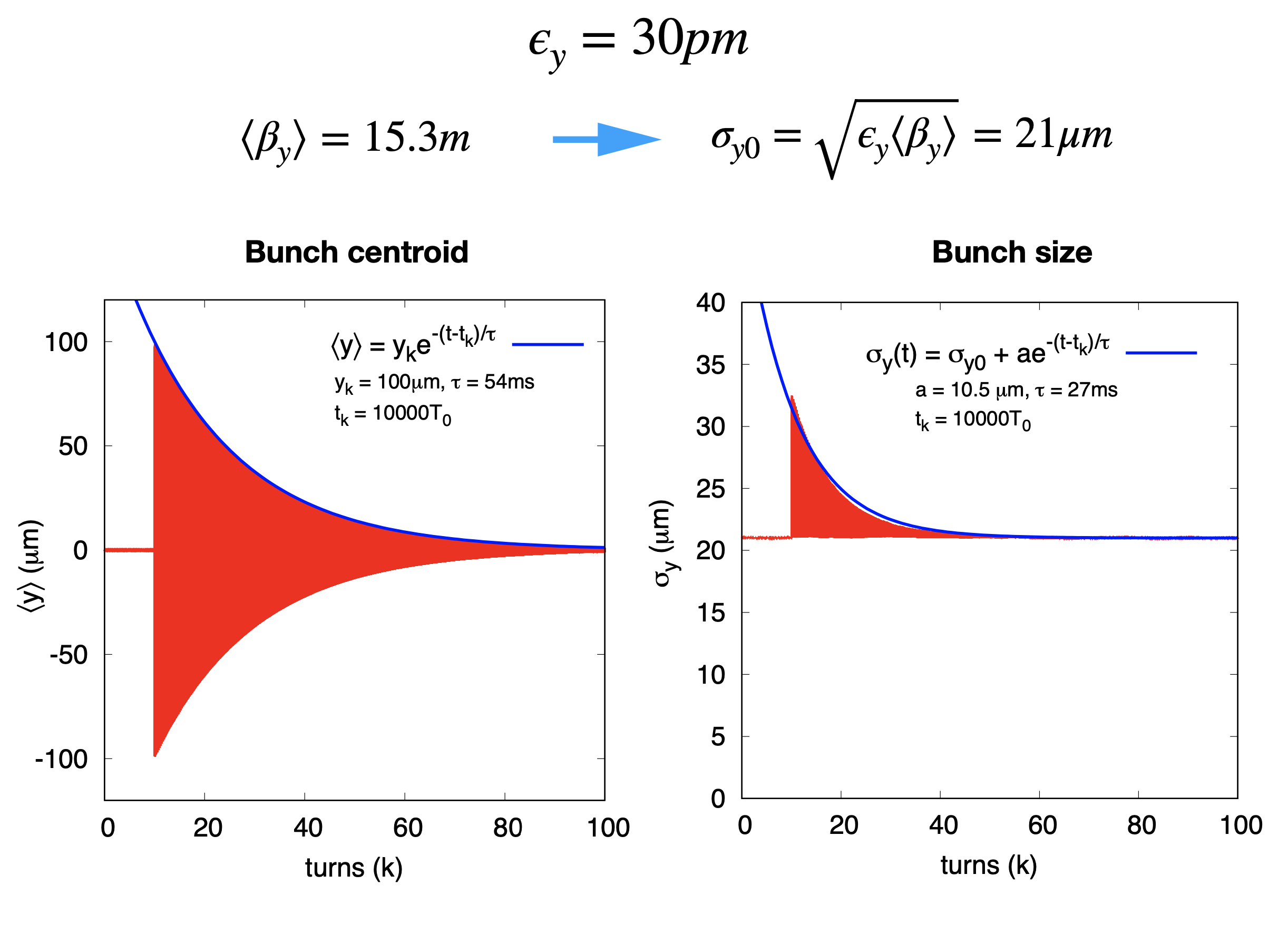

I still don't see the equlibrium beam size for coupling lattice. The initial bunch size using the average beta function of 13.8m for emittance = 30pm is ~20 microns, but ILMATRIX gives betay = 3.366872m. How does elegant compute the initial vertical distribution from the vertical emittance in this case?
We want to compare the elegant results with internal code SPACE. We obtain the following results:
In SPACE, before the dipole kick at 10k turns, the bunch is in equilibrium.
After the kick, the bunch centroid envelope decays with a damping time equal to the radiation damping time (54ms), while the bunch size envelope (substracting the equilibrium value) decays with a damping time equal to half the radiation damping time (27ms).
Please correct me, if I'm interpreting/doing something wrong.
Best,
Aamna
