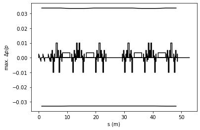

Hi Michael,
When I used momentum_aperture for one nsls2 supercell, I expected to see some fluctuations along the ring, such as small aperture at dispersive section. But I get almost two parallel lines as shown here:
I attached both ele and lte files. Do me a favor to take a look at them whenever you are free, please.
command line:
elegant LMA.ele -macro=fn=nsls2cell.mmap,s0=0.0,s1=52.7972
Regards,
-Yongjun

Post by yli » 21 Apr 2021, 08:19
Michael,
We found the problem: it was the RF voltage is too low. Anyway, thanks.
