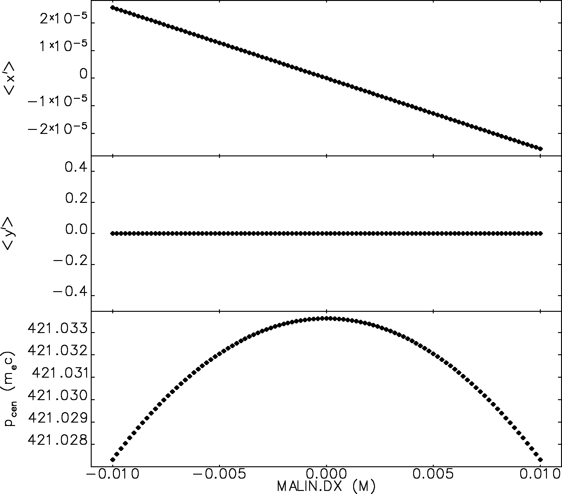

Here's an example with RFTMEZ0 showing how beam gets deflected by the radial fields. I scanned the initial x coordinate of a particle between -10mm and +10mm. At the end, the slope varies linearly due to the radial fields. --Michael

Perhaps the effect is hidden by the beam size and divergence. When I try this with a single particle, the results are as expected.

Thank you for your kind explanation with a good example.
I have checked that again and found that the kick effect is smaller than the initial angular distribution.
