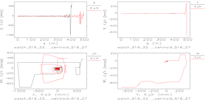

Using WATCH elements is a very resource-intensive way to do this. A simpler way is to track one particle at a time and record the centroid data. Using the wrap_around=0 setting requests that the centroid information vs s gets "unwrapped" so you can see all the turns. You can then plot (Cx, Cxp) or (s, Cx) to see what's happening in more detail. What I see is that the particle coordinates don't go instantaneously to large values, but build up to it. It does happen pretty quickly though. I think we need to recall that when amplitudes start to get large, the kicks from sextupoles (which go like x^2-y^2 in the horizontal) grow quickly.

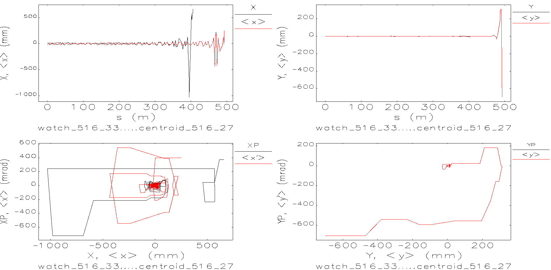

I revised some of your script and tried to check the single particle motion in all position s. In that case, the recorded data of the watch elements and centroid motion have totally different results. As far as I know, the ".lost" file records the data(s, Pass, particleID, x, xp, y, yp, etc.) of the lost moment. I attatched the script that compares the results of the tracking data. One is watch element data and the other is centroid data. In the ".lost" file, particleID 516 are lost at Pass 33. The data of the watch elements show the same results. However, the centroid motion by tracking the single particle with the same initial condition gives the different results. In this case, the particleID 516 is lost at Pass 27 and the data(s, x, xp, y, yp, etc.) are also different with the ".lost" file.
All output file of the watch elements are heavy. Therefore I didn't attached this files.
Can I believe the results of centroid motion tracking results?
If I can't, the only way to check a single turn trajectory of the lost particle is using lots of watch elements?
