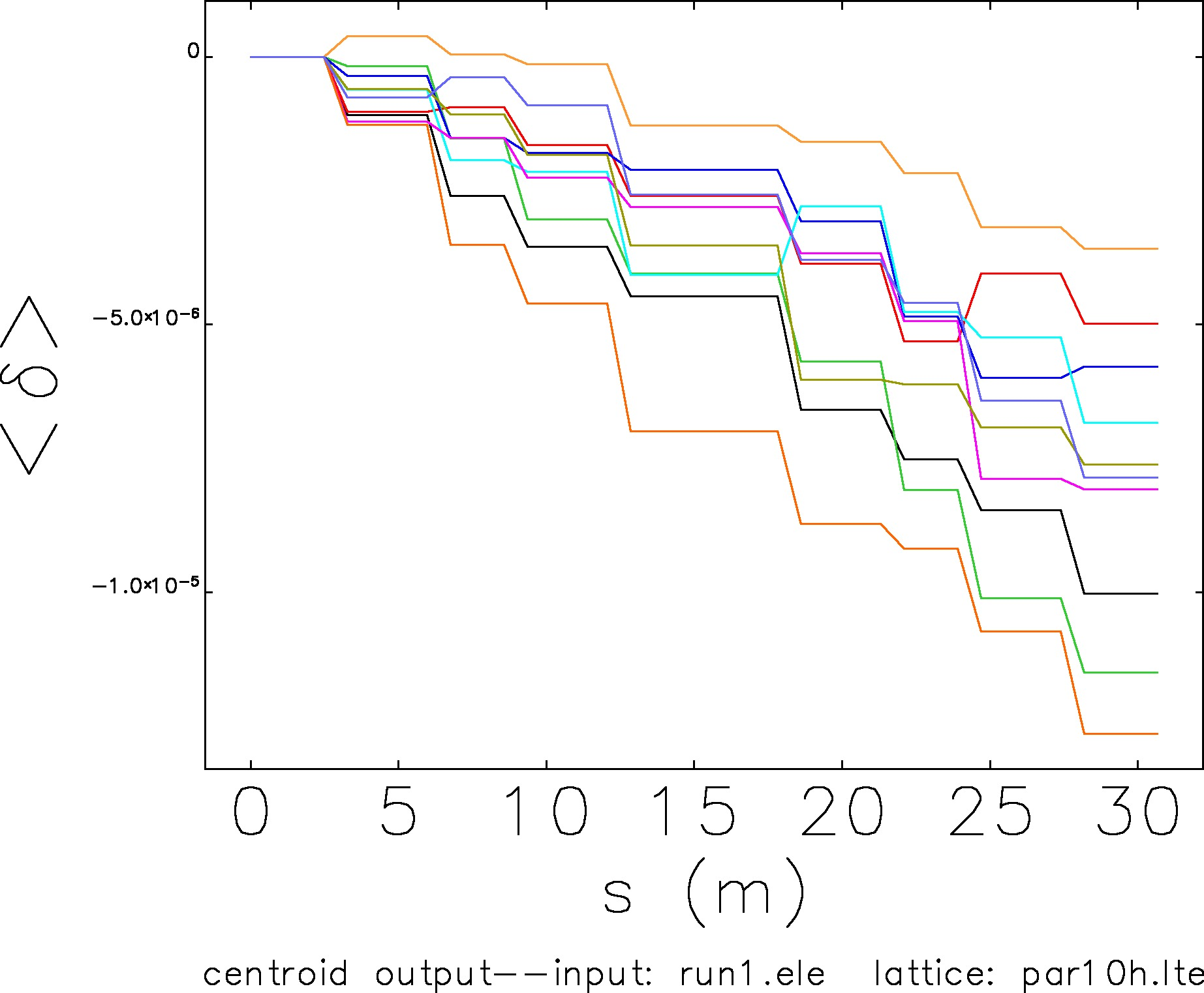

Here's an example of tracking 10 particles for one turn each, showing that they have different momentum offsets because of ISR. Also attached are the files I used to do this run.
For the second question, the response is the same regardless of whether distribution-based or gaussian-based radiation calculations are performed: the effect on the emittance originates in *subsequent* transport through bending systems. One does not need to explicitly put it into the implementation of radiation kicks. So, for example, if a photon is emitted by one electron in the middle of a dipole, the electron will start to diverge from the other electrons by virtue of getting a larger deflection in the downstream half of the dipole. This is confirmed by long-term multi-particle tracking with elegant, where we get the emittances we expected.

For question 1, when set the "DistributionBased=0", I also see the ISR effects is on. I misunderstood that the horizontal kick is off in this setting, and from your answer to question 2, I know that the horizontal kick because of ISR is on now. Another issue is that I observed that there will be some minus energy photon emitted, which means the electron will get a energy increase because of ISR, for example the red line in your picture. I thought it is not a physics process.
For question 2, I wanna to check that the exact location of the photon emitted by set ISR=1, because the location is random in real physics emission process. If we set the location in the middle by default, then maybe the flag "n_kicks" will affect our simulation result by my opinion. Is it correct?
