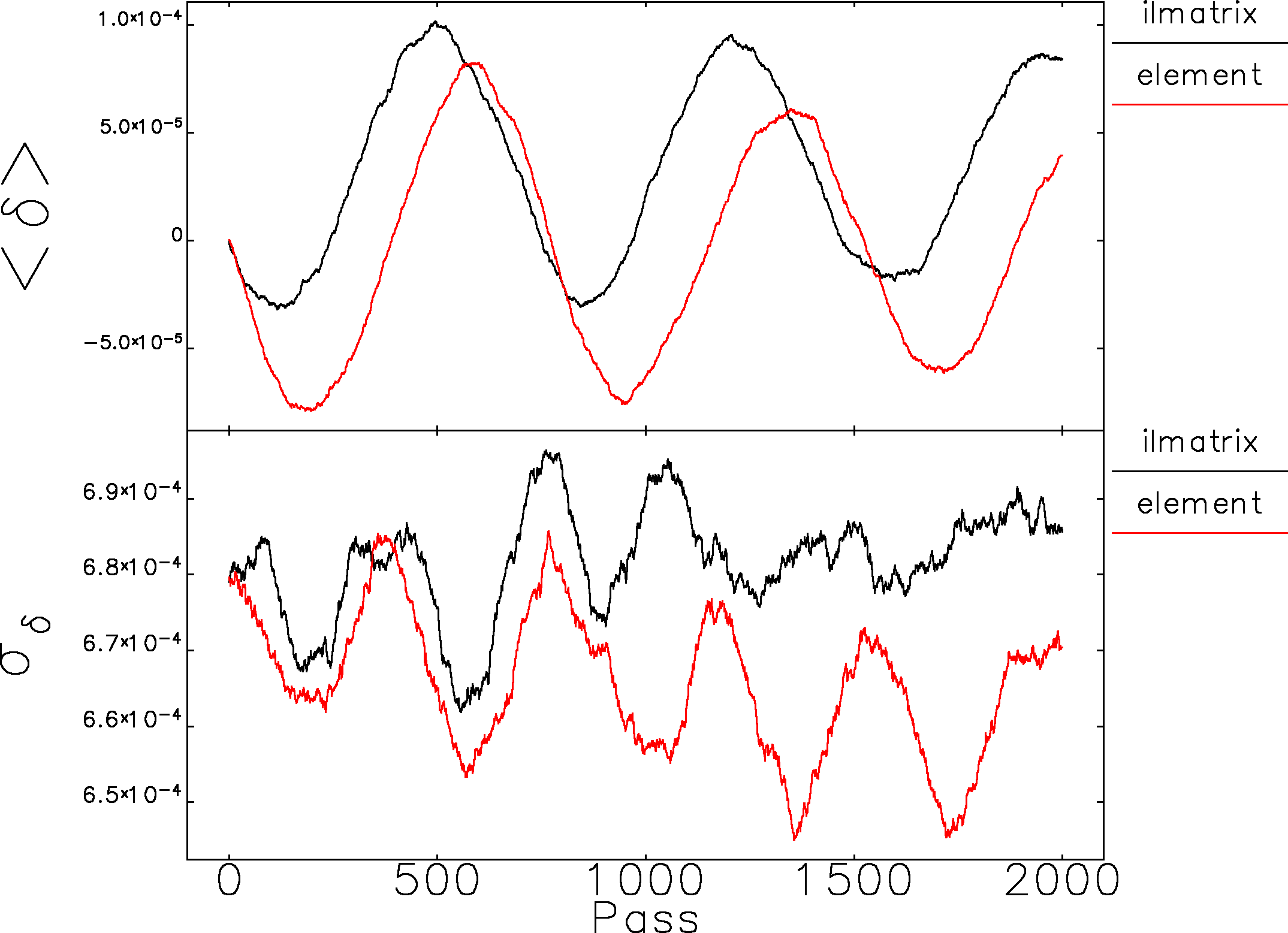

The problem appears to be incorrect setup of synchrotron radiation in the ringelement beamline. In particular, you have included SR1 (an SREFFECTS element), which gives lumped-element radiation. Meanwhile, the RING beamline includes CSBEND elements that have ISR=1, so you are getting twice the quantum excitation. You should remove SR1 from this beamline, then set ISR=1 and SYNCH_RAD=1 on all CSBEND, KQUAD, and KSEXT elements.
Another problem is that the rf cavity is at the start of the beamline. This means that on the first pass, the beam gets an energy increase that changes the time of flight through the beamline, resulting in an energy oscillation. This is different from the ILMATRIX tracking, where you have SR followed by RF (the recommended order). This will eventually damp out, but can add confusion. For better consistency, you should put the rf cavity after the RING beamline .
A less important issue is that the rf frequency should ideally be set based on the actual time of flight around the ring, which differs from the ideal value since the latter is computed without synchrotron radiation. You can get this by tracking a single turn and looking at the Ct quantity in the WATCH output file (use sdds2stream -col=Ct to get the value to full precision). That will diminish the synchrotron oscillation somewhat.
I've attached a modified version of your files that fixes the problems I found. Note that for faster testing, I reduced the number of particles and passes. As you can see, the agreement is now reasonable.
