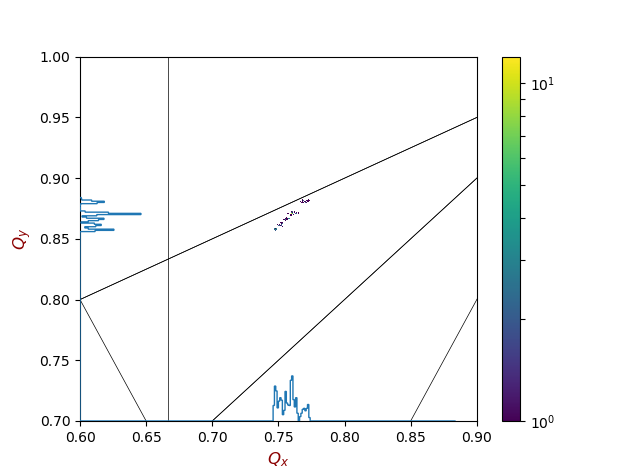

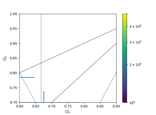

But I find a tune difference in the ring lattice between ELEGANT and formula. I calculate the tune shift with space charge about -0.1 by formula,ELEGANT gives the growth of tune by 0.1. I think the result is wrong, but how to fix it?
Tune calculation:
'sddsregroup W1.sdds -pipe=out -newParameters=particleID -newColumns=Pass|sddsnaff -pipe -column=Pass -pair=x,xp -pair=y,yp -terminateSearch=frequencies=1|sddsprintout -pipe=in W1naff.csv -spreadsheet=csv -column=*'
&insert_sceffects disable = 0, tune map: &insert_sceffects disable = 1, tune map: The .lte and .ele files see in attachment:

This is another bug. The sign of the particle charge is included in the calculation, which it shouldn't be. Since I only tested it for electrons, I didn't see this. To work around the bug, please use
instead of the pre-defined option for "proton". (Basically, this switches to anti-protons, which have the same charge as electrons and thus works around the bug.) I tried this and obtain a negative tune change, but the magnitude is not as large as you expect. However, the particles seem to be unstable and reach quite large amplitudes, so I'm not sure how reliable the results are.
The bug will be fixed in the next release. Thanks for reporting it.

I noticed another issue with this simulation. Because the emittance is so large, the integrator has accuracy issues that result in spurious non-conservation of the emittances. I don't have a solution for this at present other than using first-order matrix-based tracking, which is adequate if all you want to do is determine the tune spread.
