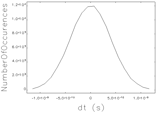

sddshist w1.sdds w1_hist.sdds -dataColumn=dt -statistics
-- this command will produce the histogram of particles with respect to dt column of w1.sdds watchpoint output. You can plot it typing
sddsplot w1_hist.sdds -col=dt,frequency -split=page -sep=page (press N or P to move between different turns saved in a separate pages of sdds file).
This is a longitudinal distribution of your beam with automatic binning. If you want to use a custom binning it can be specified in the -sizeOfBins, -lowerLimit and -upperLimit arguments of sddshist. But first it might be a good idea to use automatic binning.

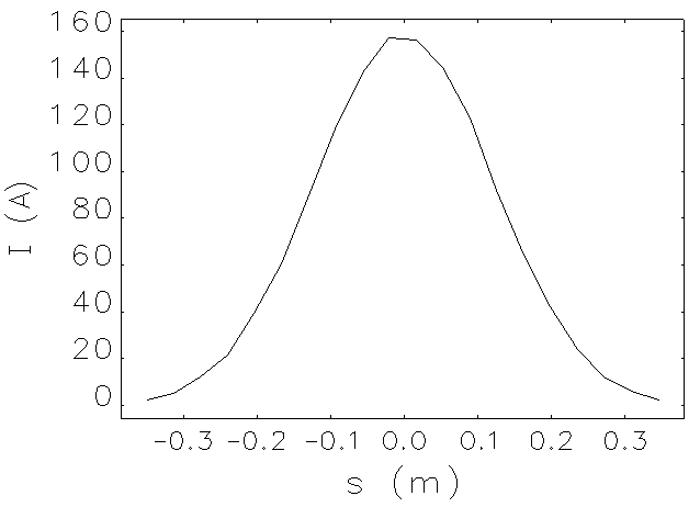

In order to calculate the beam current you need to divide the beam charge in a bin by the size of the bin in seconds:
sddsprocess w1_hist.sdds "-define=column,I,Charge Particles / frequency * sddshistBinSize /,units=A"
The human-readable formula would be I = Charge*(frequency/Particles)/sddshistBinSize
Parameters Charge (bunch charge), Particles (number of macro-particles) are already in the w1.sdds file and sddshistBinSize parameter is written by the sddshist command. (frequency is the number of particles per bin).
Now sddsplot w1_hist.sdds -col=s,I -split=page -sep=page can plot the bunch current profile: Best regards,
