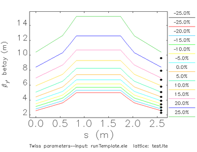

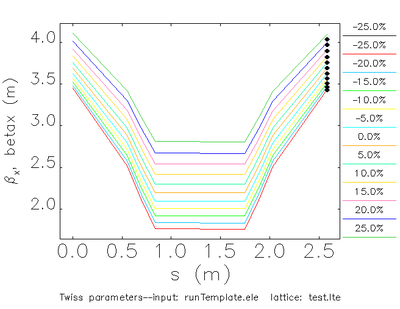

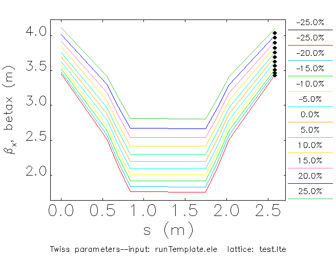

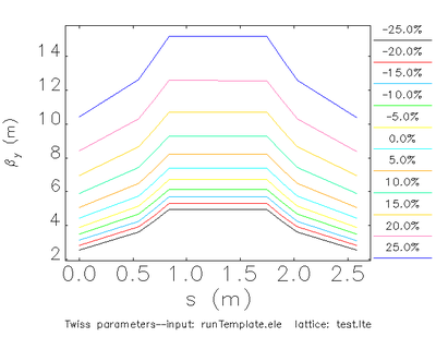

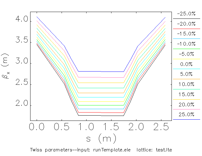

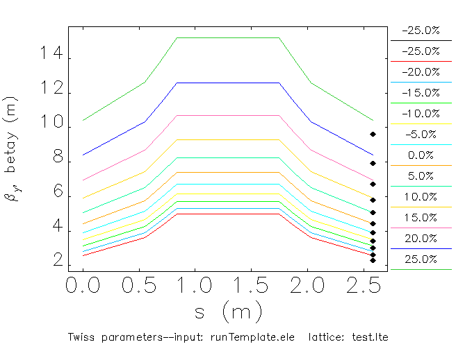

Re: close orbit for large momentum offset
Yue,
Here's an example using your lattice file that shows betax and betay changing with momentum offset.

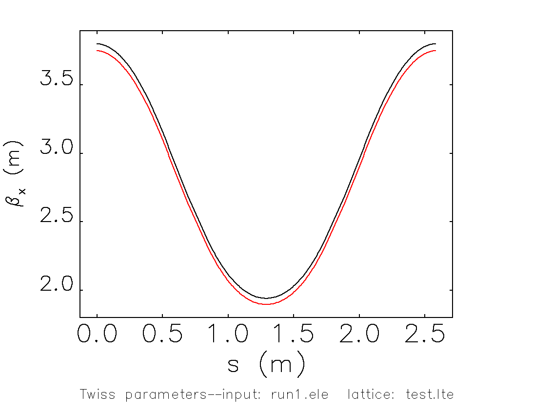

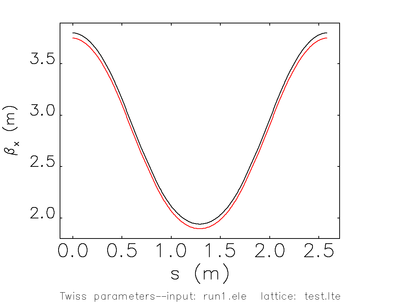

- Posts: 2057
Yue,
Sorry for the delayed reply. I've been traveling.
The output files from those two runs are not identical. If you use sddsdiff, you'll see that they are slightly different.
As a demonstration that elegant does consider the orbit when it is computed, I inserted a thin-lens sextupole into the lattice. I think you'd agree that this will only affect the twiss output if the orbit is included. In this case, the beta functions are different enough to see in a plot.
