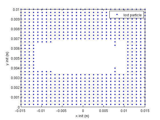

That's exactly what I was after. However, when I load in the results, I'm seeing something I didn't expect. If I select the initial coordinates of the particles that are lost, it looks as though the beam is being displaced when it is tracked. The initial coordinates go from 0 to 10 mm vertically, but the particles that survive are those centred around 5 mm vertically (see figure).

- lostparticles.png (5.62 KiB) Viewed 13144 times

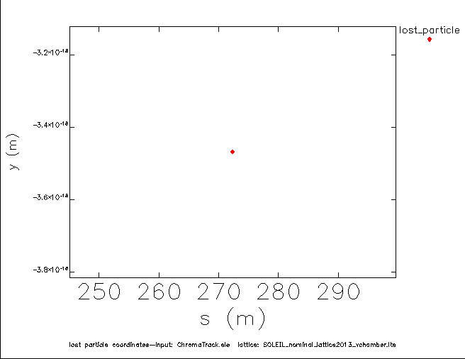

Dear all,
I have more or less the same problem as our colleague Ian.
I put the dimensions of my vacuum chamber to compute the DA using MAXAMP element (see the lattice file attached) and the particles become lost at 12 mm.
VCHAMBER: MAXAMP,X_MAX=0.035,Y_MAX=0.0125
MHU640: MAXAMP,X_MAX=0.028,Y_MAX=0.007
SDM1: MAXAMP,X_MAX=0.021,Y_MAX=0.005
SDC1T: MAXAMP,X_MAX=0.025,Y_MAX=0.0125
When I check what happens at this location I see that the particles becomes lost in a place where the dimensions of my physical apertures seem to be ok (see figures) and with a number of turn very small. In particular it's very strange because it seems that the particle is lost in the vertical plane with an amplitude tinny compared with the vertical physical aperture.
Do you have any idea of what is going on? Is it due to the mode of the watch used? In my case I used mode=centroid to make the diagnostics.
I have attached the scripts used to compute the diagnostics of this case:
1) The lattice *lte
2) ChromaTrack.ele to compute tracking at the amplitude of 12 mm where the particles becomes lost. I am also using 4D tracking.
Thank you in advance.
Have a good day
Xavier

- Lost particle at vertical plane
- lost_particle_y.png (5.15 KiB) Viewed 13087 times
