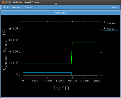

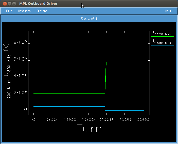

I've recently made tracking simulations of bunch rotation (RF-gymnastics) in the SPS using Elegant.
The attached example might be helpful to you since I'm using &modulate_elements with external file here.
Best regards,
Alexey
SPS (LHC injector) has two RF systems: the main one with 200 MHz cavities and another one with 800 MHz cavities. This tracking simulates RF voltage change in both cavities according to the program given in the RF_program.sdds file.

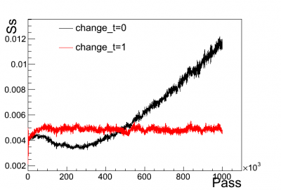

I attached the input files (it is a modification of the PAR/bunchLengthening example). And a plot of sigma_s of the tracking once with change_t set in the cavity and once without. It seems the black curve is the wrong one, is it not?
The thing is, I'd like to look at the bunch length while applying time/turn dependend modulations.

The Ss parameter is often misleading as it doesn't mean what people think it means. It isn't equal to the rms bunch length, but rather the rms spread in effective distance traveled at the instantaneous velocity.
http://www.aps.anl.gov/Accelerator_Syst ... ode13.html

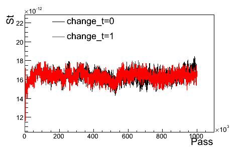

You should use the St parameter, which is the spread in arrival time at the observation point. In that case, I think you'll find the behavior is reasonable for both change_t=0 and 1.

yes you are absolutly right! I misinterpreted the meaning of s. St is the quantity I wanted and it gives comparable results for both change_t=0 and 1. Thank you for your help!
