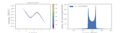

I was trying to model tracking in a TESLA crymodule, with both LSCDRIFT and ZWAKE included.
Unfortunately, I could not get rid of the noise in energy distribution for small transverse radius, without cutting off the frequency at very low value and choosing very small number of bins.
For instance, with transverse radius about 10^-5, I have to set LSC_HIGH_FREQUENCY_CUTOFF0=0.1, LSC_BINS=200, sg_order=2, sg_halfwidth="4" to module just LSC in RFCW, to get rif of the noise.
RFCW with LSC only.

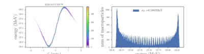

However, if I include ZWAKE together, I will see the noise in energy distribution again.
RFCW with LSC and ZWAKE.
Is there something wrong with parameters that I used ?
I attach my scripts for your reference.

As the beam radius shrinks, the spectrum of LSC extends to proportionally higher frequencies. This makes the simulation more sensitive to high-frequency noise in the particle distribution. You should increase the number of particles and also consider using Halton sequences (see the manual page for &bunched_beam).
