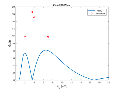

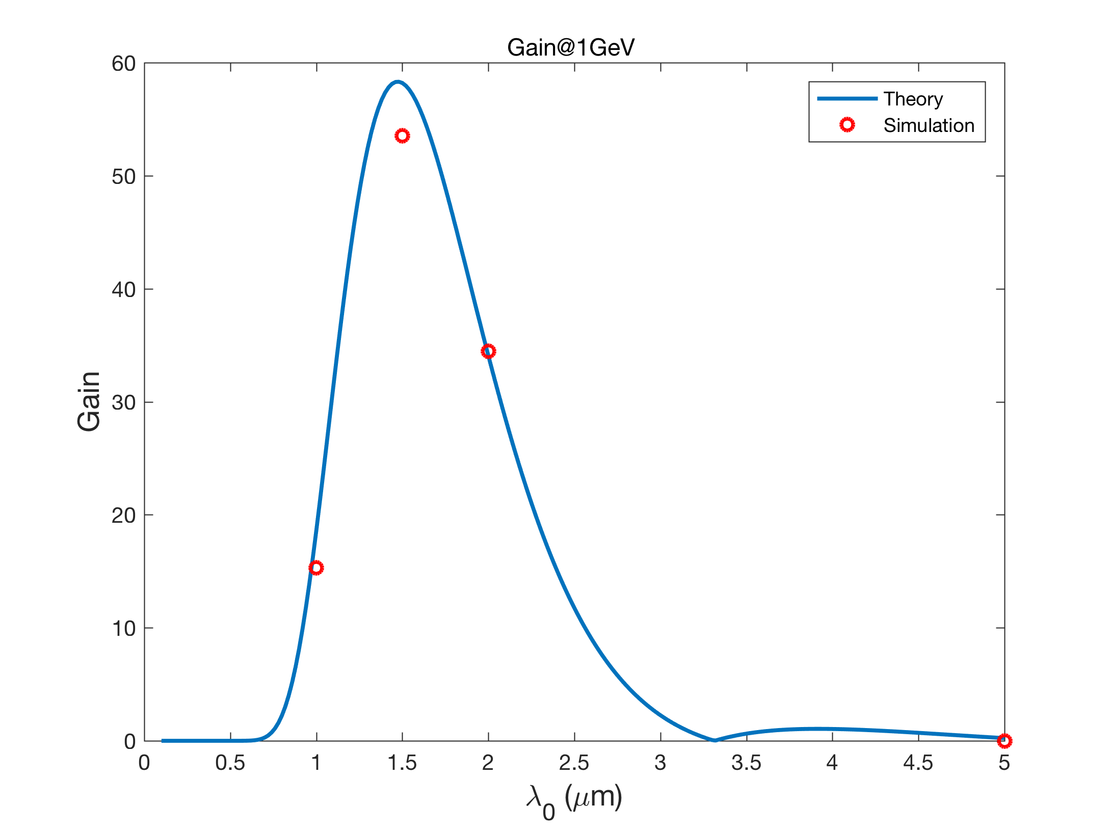

I am doing simulations about three-stage microbunching instability study. I used a simple model {drift1,BC1,drift2,BC2,drift3,BC3} (where all three BC are EMATRIX elements to only introduce r56, no compression) to benchmark my theory equations.
When I am using beam energy as 1GeV, they agree well with each other (the peak position with larger difference),
But for 100MeV case, much larger difference can be seen. I want to make sure the difference is coming from r56 in drift section which was not considered in my theory calculations.
So I want to modify the source code to make sure particle longitudinal position doesn't change in the drift. I tried to search the source code to find where I should make the modification, but it seems not quite easy. Could you do me a favor telling me which source file I should go into ?

Hi Michael,
I used LSCDRIFT element to introduce energy modulation, then followed EMATRIX to give r56. So the Lattice actually is simply {LSCDRIFT, EMATRIX, LSCDRIFT, EMATRIX, LSCDRIFT, EMATRIX}. What should I do with LSCDRIFT to turn off longitudinal motion ?

Hi Michael,
Yes, I noticed the line in lsc.c you showed me, so I basically made the initial particle distribution with xp=yp=0 in the simulations (also for constant beam radius making theory calculations for LSC impedance easier), so there are no position changes due to xp and yp.
According to the simulation results I showed with 100MeV and 1GeV, it seems that the gain for a lattice layout which consists of three Bunch Compressors is quite sensitive to r56 in the drift section due to the velocity modulation originating in energy modulation. That's the reason I want to turn off the particle position changes due to energy-velocity-position dependence in the drift.
Actually I have successfully modified the simple_rfca.c to longitudinal-frozen and linear-chirp model in RFCW element. But for LSCDRIFT, I tried but failed finding the place to make such modifications. It seems not in lsc.c file.
Best Regards,
Biaobin
