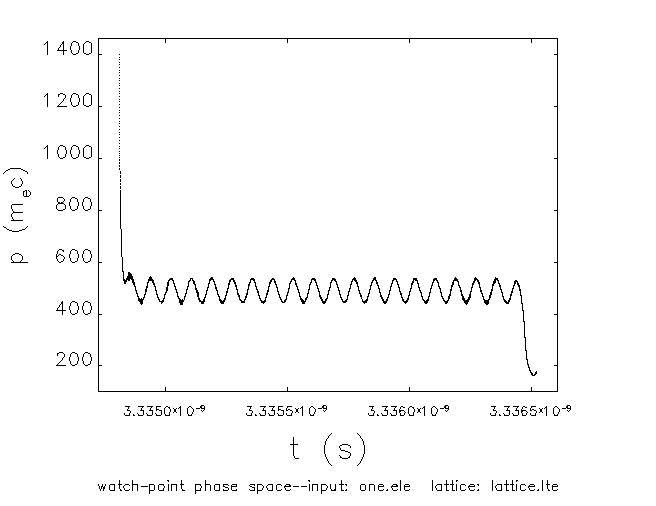

Sorry to disturb you again. I am doing microbunching instability study in Linac with elegant. I have two questions about the LSC model in Elegant.
- Does elegant consider about the energy chirp effects to the whole beam?
Physically, the head should be accelerated due to LSC, the tail decelerated.
The following picture is a simple example with 1 meter lscdrift . Only energy modulation due to initial density modulation is seen. I tried increase the beam current and transfer distance, still can not see the chirp effects.
- I want to consider about the LSC in Linac, but keep Linearize=1, which will need to keep N_KICKS=1 to consider LSC. So I divide the cavity to many parts and make sure the single cavity length is small enough. Is this method valid ?
The example file is attached. The input.sdds file seems too large, which is generated using matlab to introduce the density modulation.
