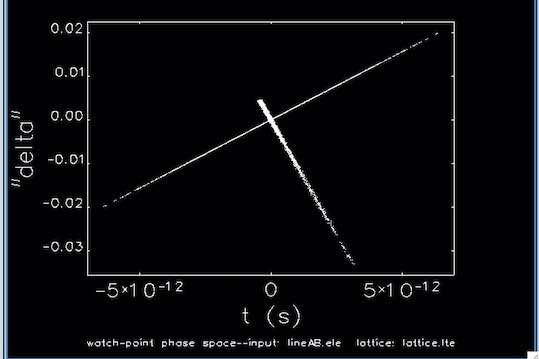

I am using two chicane compressors to compress the bunch, and using the RFCA cavity to dechirp the beam at last. But the final longitudinal phase space is quite strange. All the elements are used first order matrix, I checked the dispersion line and R16 R26 in the *.mpr file, the lattice is actually achromatic. Is there some wrong settings in the *.ele or *.lte files ?
The phase space figure(the initial and final one) is as following:
The .ele and .lte files are also attached.
Thanks in advance and wish you a happy Thanksgiving day.
Biaobin

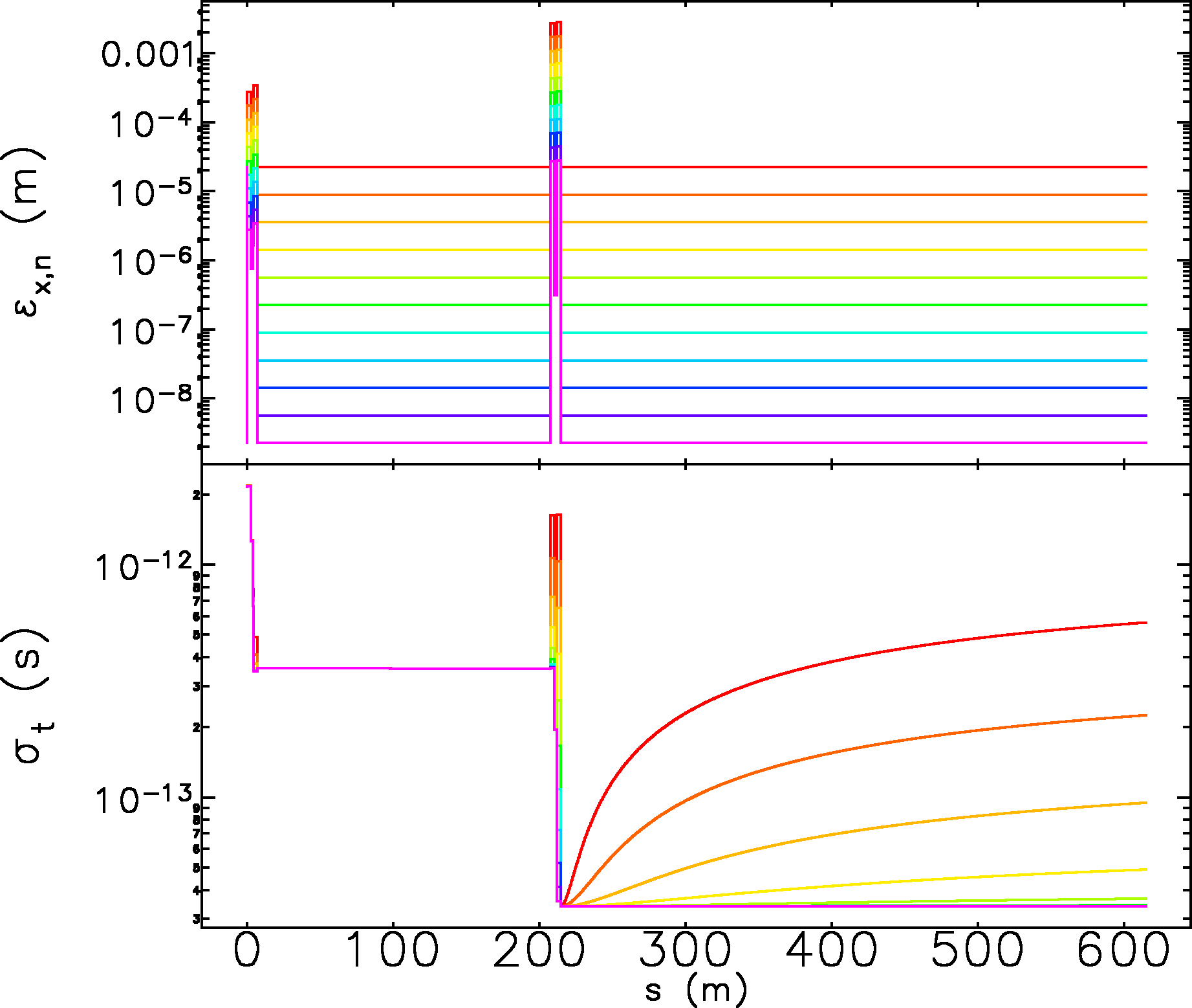

Biaobin,
The problem is that the beam emittance is too large to preserve such a short bunch length. The dependence of the path-length on transverse angle results in growth of the bunch length downstream of the last chicane.
I checked this by using a MAGNIFY element to vary the emittance of the beam. As the emittance decreases, the bunch length is maintained more closely to the value at the exit of the final chicane.
You need a normalized emittance of about 1 um to preserve the bunch length.
