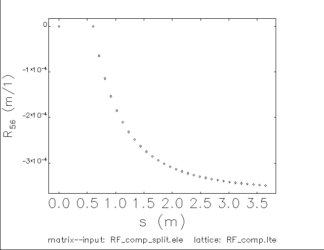

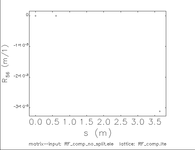

Re: TWLA problem and extract transport elements in a cavity
Dear Michael,
Thank you for pointing out the quotation mark issue in my original file. Now the final momentum is resolved. By dividing the element of TWLA, now I can extract transport matrix elements R5x from the output file (*.mat). However, I found the output results (say, R56 vs. s), with and without dividing TWLA, are different. Without dividing the element, I know the output R56 only records the initial/entrance and final/exit of the element.
The final R56 (i.e. R56(s_exit)) should be the same for both with and without element division, is that right? But, it looks quite different (please see below the two attachments). Actually, I am not sure how ELEGANT calculates such transfer matrix elements inside TWLA. Could you refer me to some specific source file of ELEGANT or give some hints about the algorithm?

- Posts: 2065
Cheng-Ying,
The TWLA matrix is a basic rf cavity matrix, like that used for RFCA. It isn't expected to be reliable for low-energy beams.
Elegant has the ability to determine the matrix from tracking, which would be a better way to handle this. You might try using the analyze_map command, which also determines the matrix from tracking.
