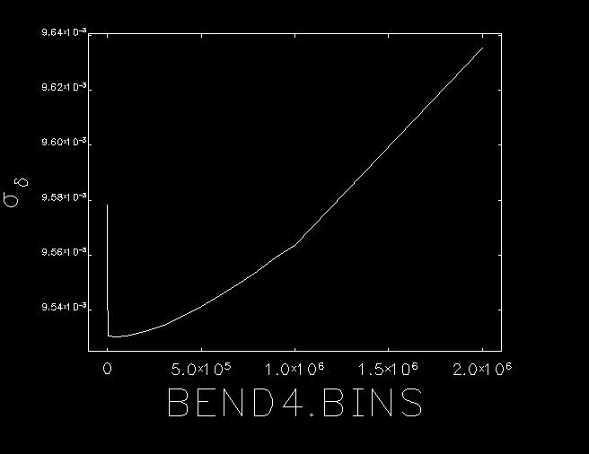

Hi Michael,
So, Ive been looking at this issue for a little while and think I may have some idea:
The strong compression causes a long tail towards the end of the compression cycle (Bends 3 & 4). So, when the user defines the BINS for the CSRSBEND element Elegant calculates the BinSize according to the entire bunch length; for the last two bends the bunch length is very long. The long tails of the last two bends requires an even smaller BinSize (i.e. larger BINS number) to resolve the peaks of the long tail distribution.
BUT, I understand that increasing the BINS number too much will create a messy high frequency linear density and even more messy linear density derivative in the CSR calculation.
So, to test things out I ran a scan of BINS for the 4th bend in my system (attached are the results) with CSR, ISR turned off everywhere but CSR ONLY turned on in the 4th bend. I am a little confused, I was hoping that there would be some sort of taper or convergence as I increased the BINS but as you can see the Sdelta continues to increase even after 2e6 BINS.
Do you have any opinions or ideas on helping me understand this a bit better? Or any corrections to my thought process thus far? Any help would be greatly appreciated!

You need to be sure to increase the number of particles in proportion to the number of bins, otherwise the noise increases and that alone could cause the energy spread to increase.
