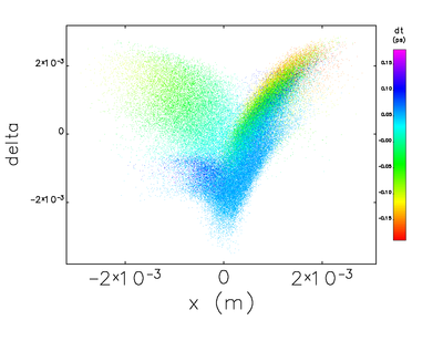

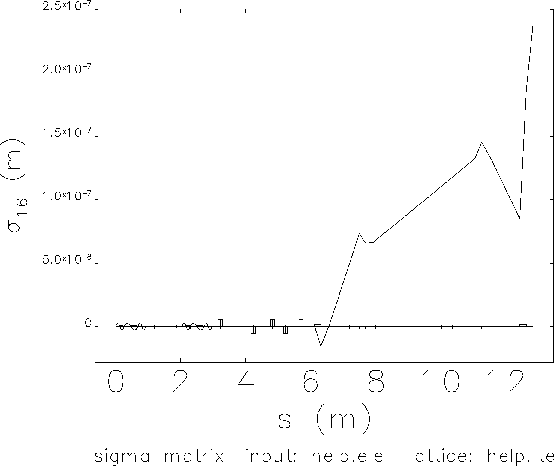

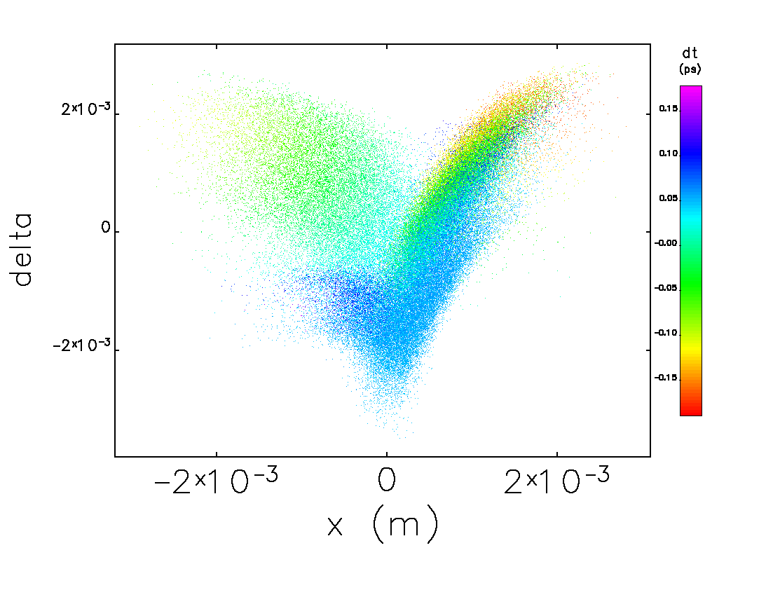

The problem is that although the dispersion is nominally cancelled, CSR kicks inside the chicane introduce correlations between x and delta. This probably originates in the last two dipoles, where the bunch is short. See attached plots. --Michael
