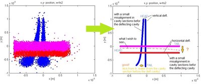

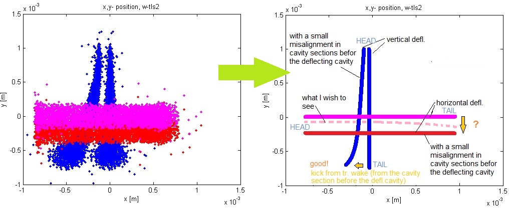

Please, find attached to this post a simplified lattice and a beam file (it is not completely optimized yet but it works…). I also tried to make a small sketch (jpeg-file).
I’m interested in the effect from the transverse wakefields in a RFCW- cavity section (L04) that is placed before the deflecting cavity. (In this lattice I have two deflecting cavities placed after each other, one horizontal and one vertical.)
I misalign the RFCW-cavities to have a stronger effect from the wakes when the beam passes of axis.
Then I would like to deflect the beam to see the head and the tail on a screen (and see how the tail has suffered from wakes).
Using vertical deflection (and a dx= 0.002 in the RFCW-cavities) I can see the how the bunch tail have received a kick from wakes in the previous cavity section. But if I put dy= 0.002 in the RFCW-cavities and do a horizontal deflection I can just see change in position on the screen?
