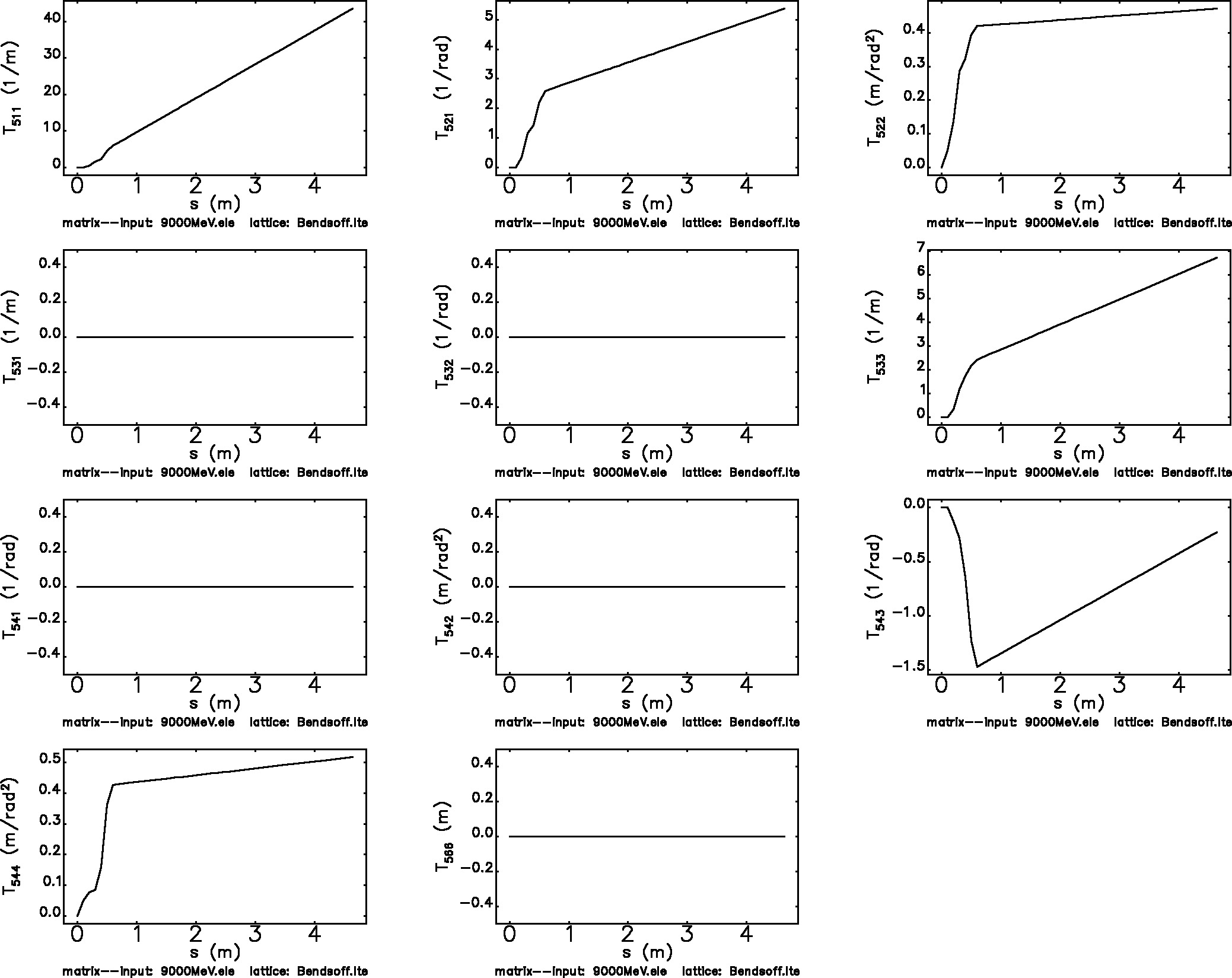

- Posts: 2060
Re: Longitudinal behavior- Bendings_on/off
Samira,
The bunch lengthening results from second order effects in the path length. E.g., in a drift space of length L, one has T522=T544=L^2/2.
You can see this by plotting the T5?? elements from your matrix.sdds file. Also, if you set the emittances to zero, you'll see that the bunch length increase largely disappears. (There's still some tiny increase due to the energy spread.)
