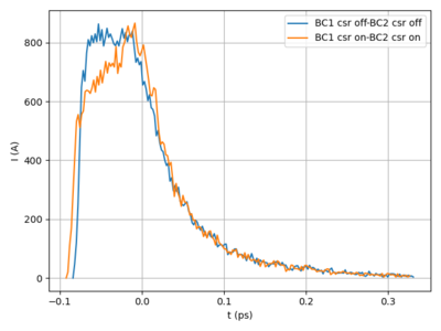

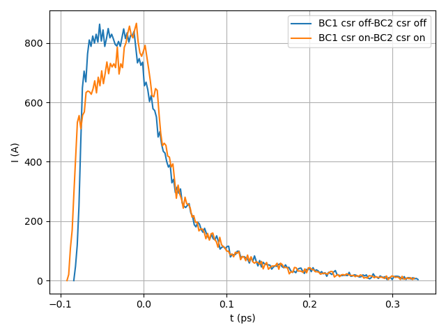

Hi Michael:
I used 4 CSRCSBEN elements to define a bunch compressor, and varying the angel of the CSRCSBEN elements to match R56. I obtained different current profiles when turning on and off the CSR effect. When the CSR effect is turned off, I obtained the desired current profile. When the CSR effect is turned on, there is a spike in the current profile at the tail end. Is this caused by the CSR effect or an error in my code? If it's caused by the CSR effect, how can I eliminate the spike at the tail end and make the current profile more uniform?
Best Regards!
Zhenbiao Sun
