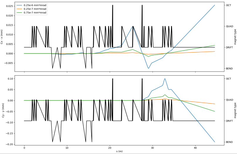

When I compare the centroid of the beam with the location &correct stored in the %s.traj file, I see the following: Some things to note:
A) The difference between Cx and tx grows in the x plane when the beam encounters CCBEND, CSBEND, and KOCT elements.
B) The difference between Cy and ty grows in the y plane only after the second octupole element (a KOCT with K3 = 1e5)
When I turn the octupoles down to K3 = 1, the difference in the x plane decreases by about 10 and the difference in the y plane decreases by about 1000. So the problem appears related to non-linear terms.
C) When I turn the emittance off, the problem disappears and the size of the difference grows with the emittance: (the blue lines in this plot should be the same as the blue lines in the earlier plots).
