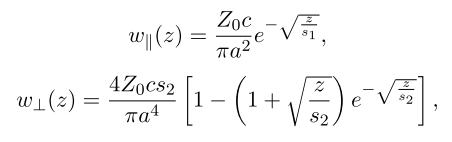

This is my first time using elegant. I am attempting to model an energy compression system consisting of a magnetic chicane and a linear accelerator. I am using the TWLA element to model the accelerator followed by WAKE, TRWAKE elements to model the wakes of the TWLA. I have simulated my structure using shorter and shorter bunches and have found the structure's longitudinal and transverse wake functions are reasonably approximated by Bane's analytic equations:
where a, s_1, s_2 are based on the geometry of the structure.
1) For my accelerator geometry, the Bane's approximation equations are valid up to z=5mm (1.67e-11 sec) behind the charge that excites the wake. The bunch entering the accelerator is 17mm (5.67e-11 sec) long. Should I make my wake function input file zero for all times greater than t=1.67e-11 sec? If I don't set the wake function to zero after t=1.67e-11 sec, does Elegant apply an energy change to the tail of the beam that it should not (is not physical)? Does this upper limit of the approximation not matter if my simulated wakepotentials for short bunches follows the approximation further out than the upper limit of the analytic function?

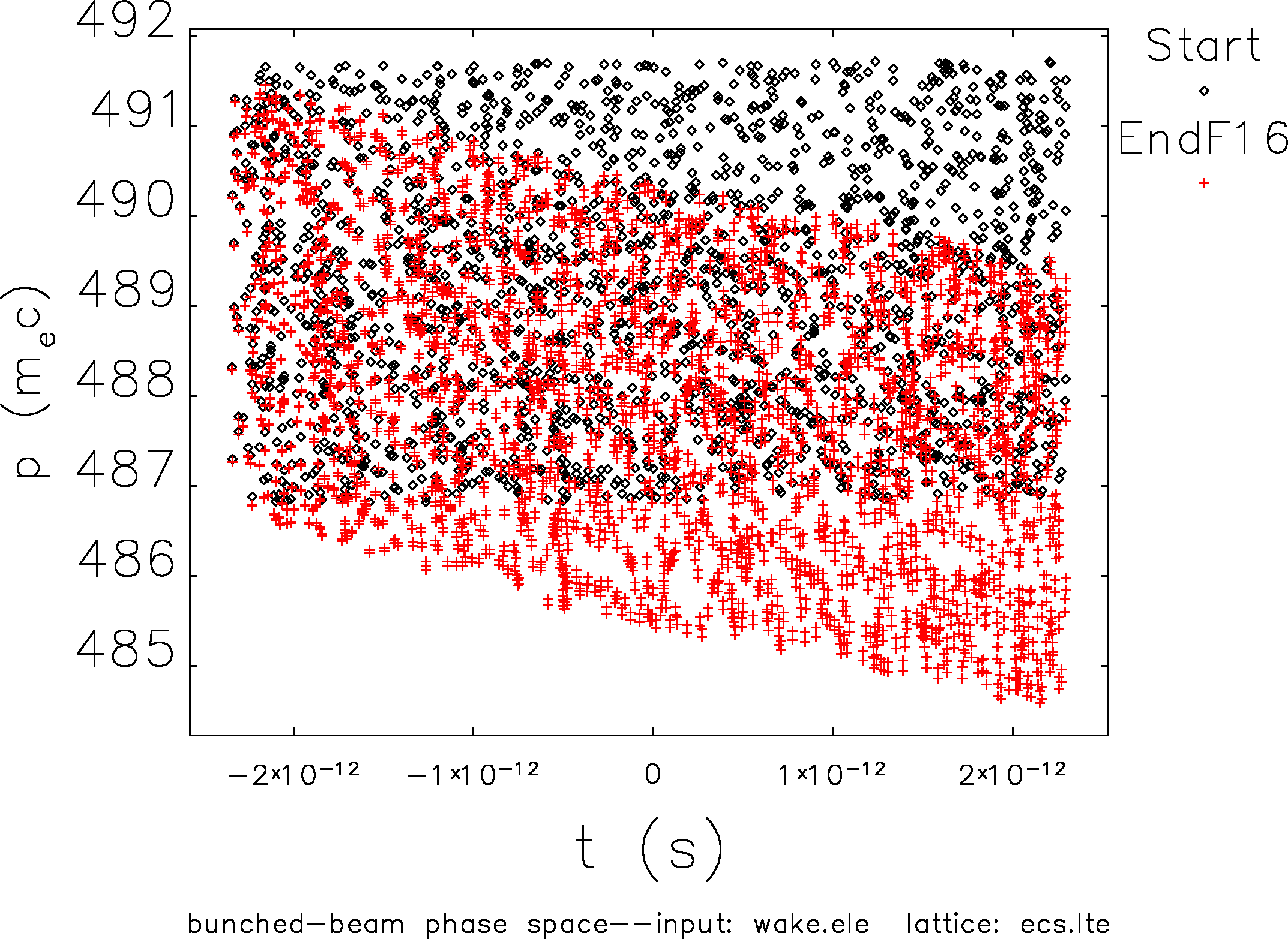

Using the WAKE element and its default factor, I do not see any wake effect on the longitudinal phase space. Only when I put FACTOR=16 do I see an effect. Does using a factor of 16 effectively model a structure of 16*16 cells (not what I want)? Why is there no visible effect when FACTOR=1?

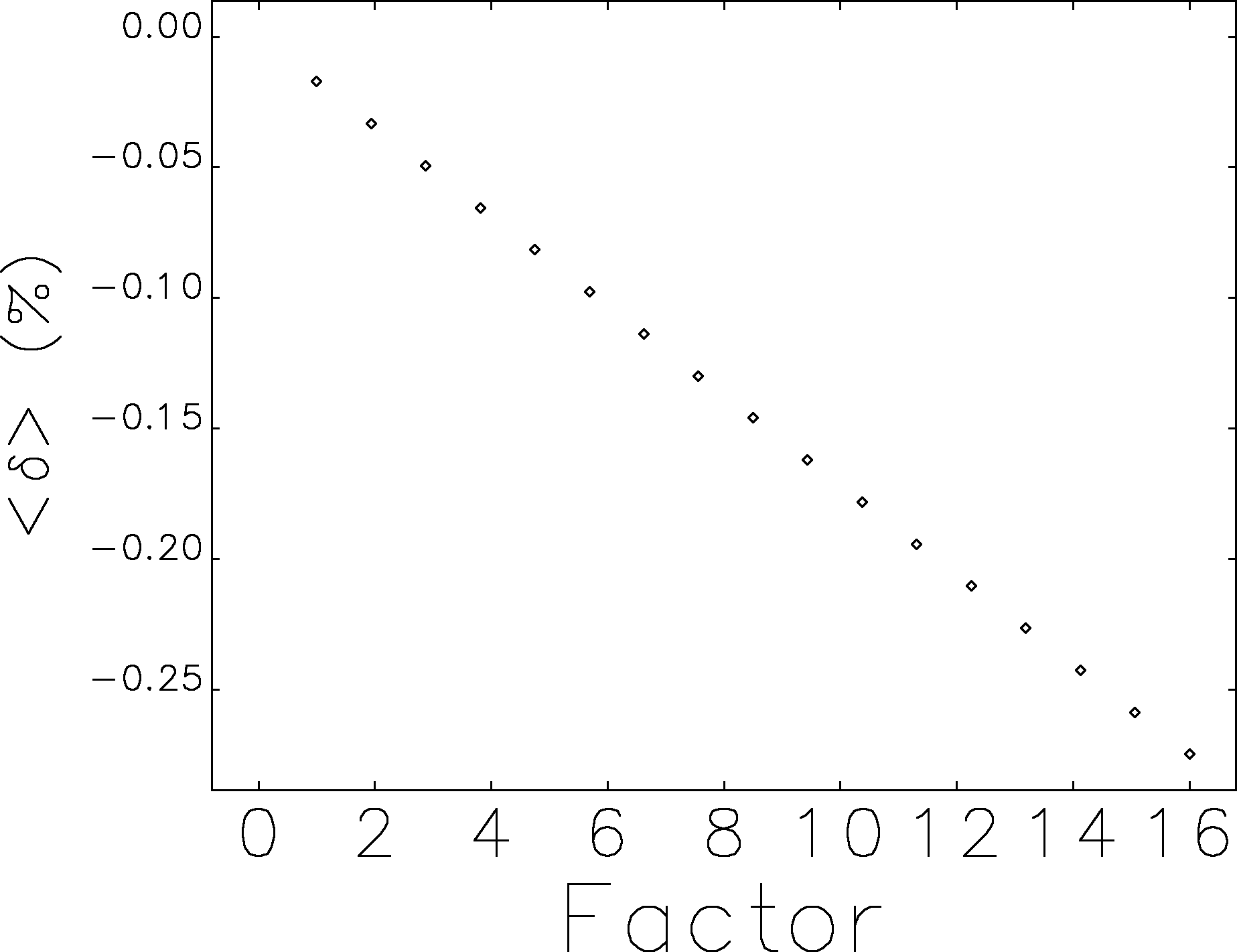

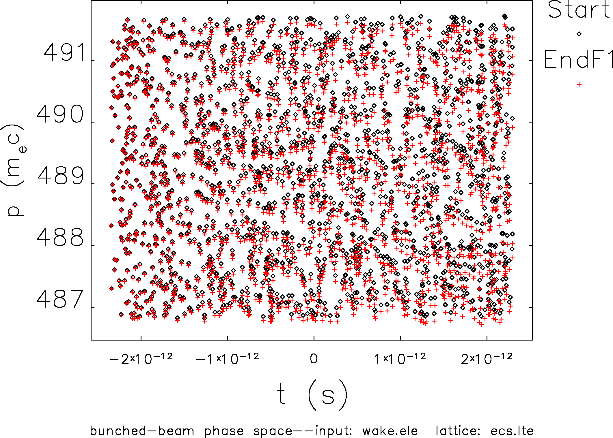

The lattice file you sent didn't seem to use the WAKE element. However, it was easy enough to set up a simple beamline that consisted of just a CHARGE element and a WAKE element that uses the wake file you provided.
I find that as I vary the FACTOR parameter, the final momentum deviation varies linearly, as I would expect. The effect on the phase space is subtle for FACTOR=1 and obvious for FACTOR=16, but a factor of 16 will do that. Unless I'm missing something, the results seem fine.
