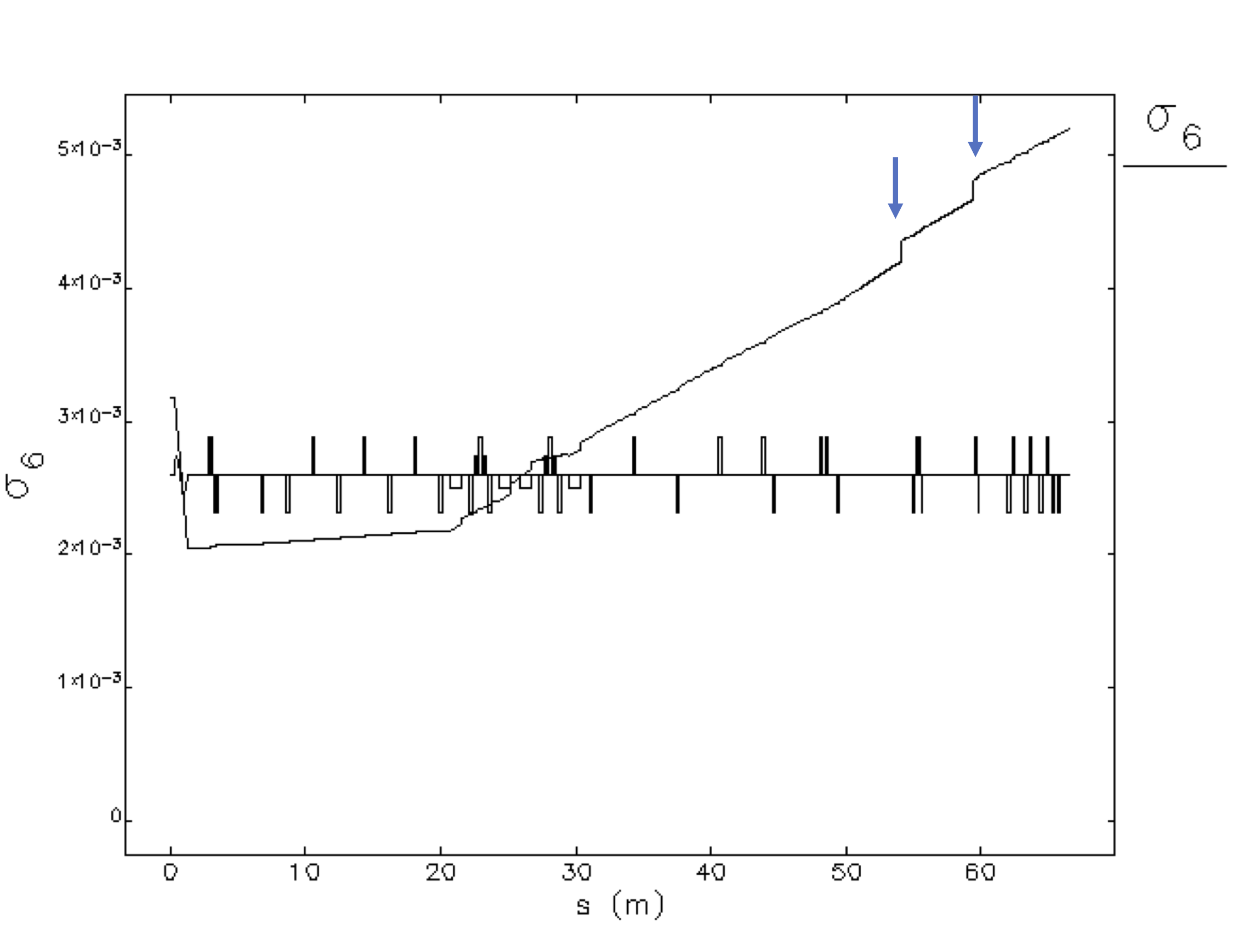

Next I have another question about the same simulation result.
In the attached figure of the momentum spread along the beam path, there are two small jumps pointed by
arrows.
I also write the beam parameter values around the two jumps below.

Both jumps occur at L12 elements (CSRDRIFT elements with LSC on) just after two undulators made of WIGGLER
elements(UND0) and LSCDRIFT elements having the same effective length (LSCUND), which are defined below.
UND0: WIGGLER,L=0.024,K=1.421,POLES=2
LSCUND: LSCDRIFT,LEFFECTIVE=0.024,BINS=100
There are two more L12 elements just before the two undulators, but such jumps of the momentum spread are not found.
I cannot understand why these jumps of the momentum spread appear in the short drifts (L12) only at the exits of the undulators.
Please let me know if you understand or find the reason.
