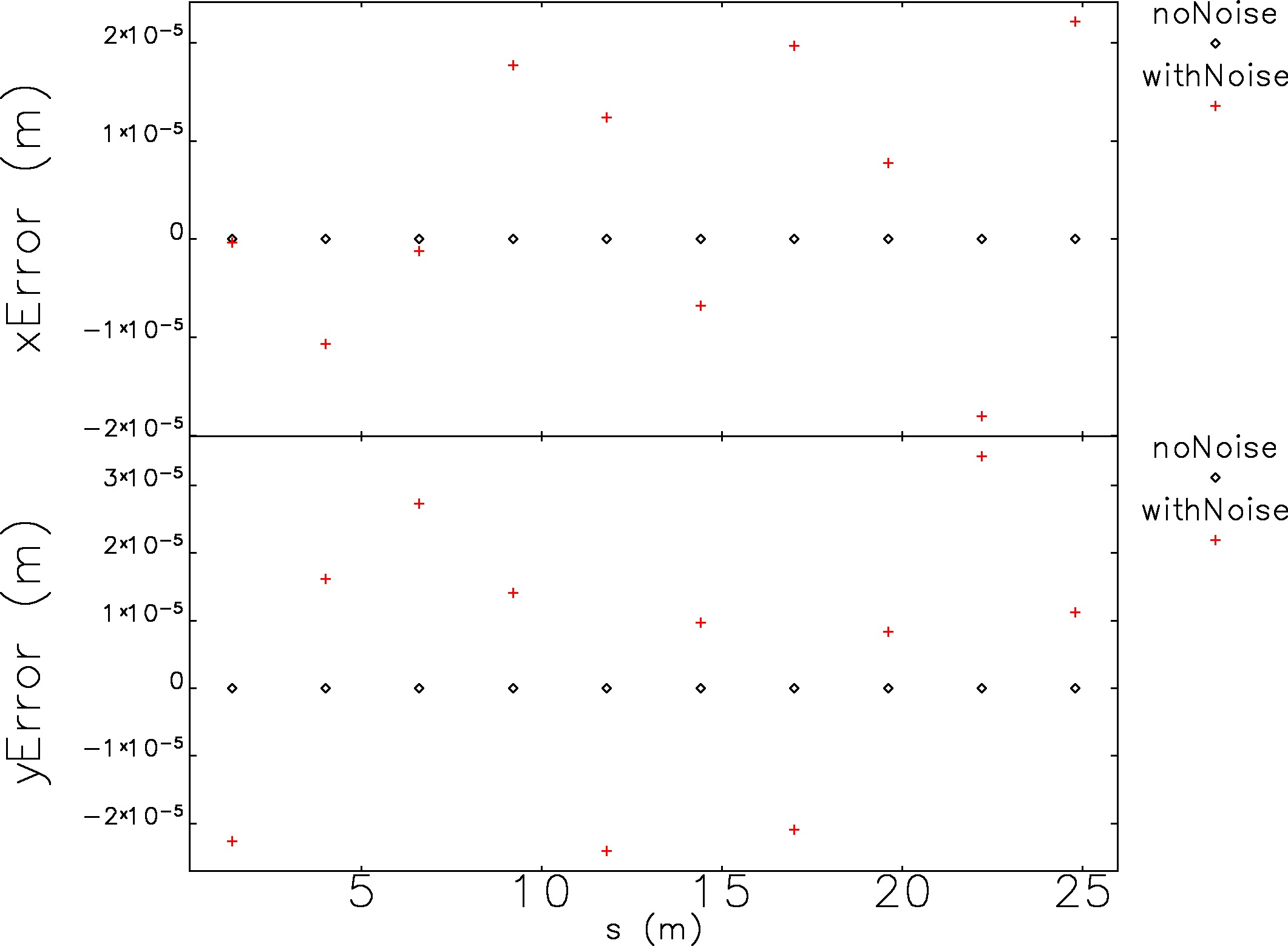

The values you provided for BPM noise should produce the desired effect of 50 micron noise. However, it is important to appreciate that this noise varies from reading to reading of the same BPM. Hence, it will manifest itself in poor convergence of the trajectory, even for large numbers of iterations. See the attachment for an example of this.
