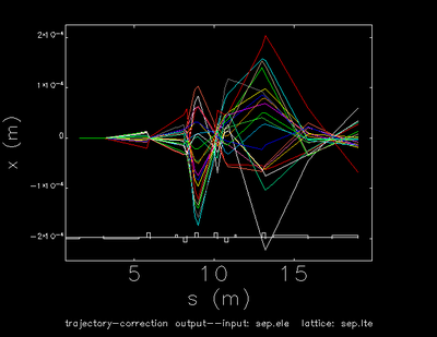

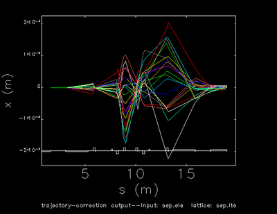

When I correct orbit in transport line. The x direction trajectory seem not correct.
sep.rar
(1.44 KiB) Downloaded 754 times
corrected trajectory is as follow.
uncorrected trajectory is as follow.
What's wrong with my files?
Thanks a lot!

There seems to be a problem with the trajectory output file not correctly showing the uncorrected trajectory. For now, please use the centroid output file from &run_setup. If you run with and without correction, you'll see a difference.
Also, I'd suggest using n_xy_cycles=2 and n_iterations=5, to ensure convergence.

I've confirmed that there is a bug in reporting the uncorrected trajectory. What's actually reported is the trajectory at the end of the next-to-last correction iteration. This will be fixed in the next release.
Thanks for reporting the problem.
