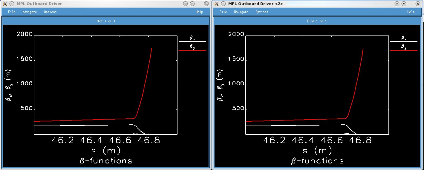

I'm trying to simulate a radially focusing lens using QUAD or KQUAD with RADIAL=1.
The problem is, apparently the RADIAL option has no effect for KQUAD element.
Would you expect this?
Attached are two figures, QUAD.jpeg and KQUAD.jpeg, illustrating this.
The left plots in each file are for RADIAL=0, the right ones for RADIAL=1.
For QUAD element everyting is as expected (focusing/defocusing for R=0 and focusing/focusing for R=1, while for KQUAD it's focusing/defocusing for both RADIAL=0 and RADIAL=1)

Post by michael_borland » 23 Oct 2015, 08:53
Slava,
This is a bug in the twiss parameter computation for KQUAD. The fix will appear in the next release.
If you build from source, you can use the attached file to get the fix.
Thanks for reporting the bug.
