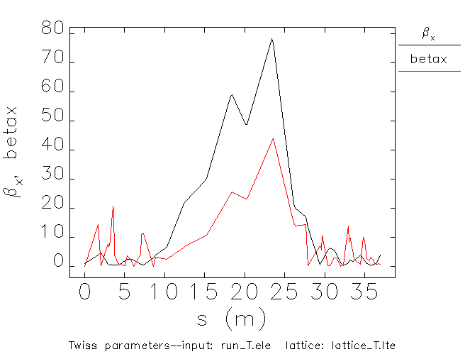

As these approaches brought different results, I tried to calculate betax from the enveloppe and emittance (via betax=s1²/ex), as our group did before in a non-elegant simulation. The result was that this betax and the one from the twiss-file differ significantly (see the attched picture, black: from twiss_output, red: calculated from enveloppe). Consequently, this resulted again in a completely different chromaticity.

2. Where could the difference between the two beta-functions in the picture above come from?

- compare_beta.png (7.72 KiB) Viewed 7692 times
