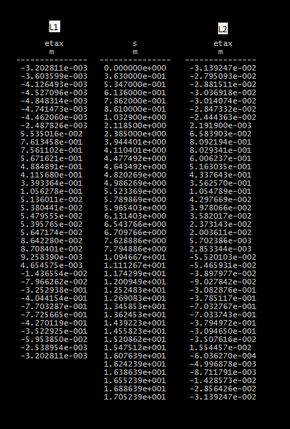

I'm trying to close the dispersion in a dogleg using Elegant.
The problem is that the whole behavior of the "etax" parameter found in the *.twi file changes if I change the end of the line.
To explain better the problem i want to show you the data I'm talking about, I use two different lines:
L1: LINE=(D1, Q1, D2, Q2, D3, Q3, D4, B1, D5, Q4, D6, Q5, D7, Q6, D8, B2, D9, Q7, D10, Q8, D11, Q9, D12, Q10, D13, B3, D14, Q11, D15, Q12, D16, Q13, D17, B4, D18)
L2: LINE=(L1, Q14, D19, Q15, D20, Q16)
As you can see L2 is the first line plus a quadrupole triplet in the end. The really strange thing is that after the tracking I obtain different initial value of the etax parameter.
This is the L1 dispersion: and this is the L2 dispersion: these are the values of the parameter in different positions I really can't see where is my mistake, can you help me please?

One problem may be that you are using periodic lattice function calculations in &twiss_output, since this is the default. I suggest turning this off by setting matched=0 in &twiss_output.
