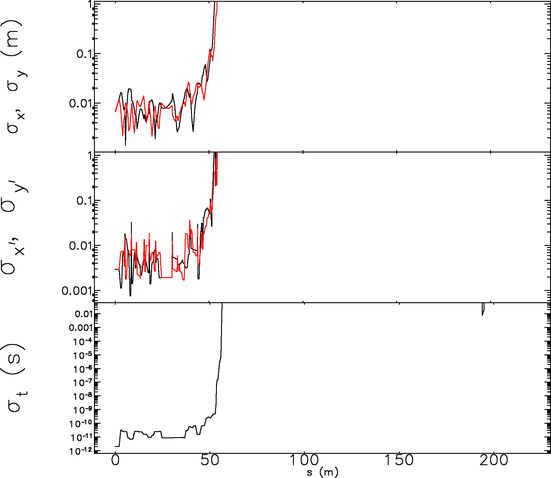

There is still same error . From last three days, every time when I run the elegant file it shows different bunch length with same parameters.
Sometime it shows beam radius is zero in LSCDRIFT.
Error:
The beam length is 9.725086e-11 s, while the wake length is 8.339102e-11 s
(The beam length varies from e+06 to e-11 that is strange.)
Please check the bunched_beam.
Thank you.
Aamna

- Posts: 2059
Re: Microbunching Instability Simulation with LSC
Aamna,
The root of the problem seems to be that your beam is not properly controlled in the transverse plane. This leads to very large slopes, which affects the time of flight, which in turn results in a very long bunch.
To see this, simply disable all the wake and LSC elements (set TRWAKE=0, ZWAKE=0, and LSC=0 on RFCW elements, and set LSC=0 on LSCDRIFT elements).
