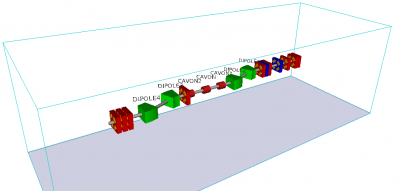

I have been playing with the view3dgeometry that comes with elegant. Have to say...pretty neat...I have some RF cavities in my simulation and when i run the command view3dgeometry with the floor file and showName ''*QUAD* *RF*" it complains that it does not understand *RF*?
Is there a work around for this? Thanks. will be great if i can see my cavities...

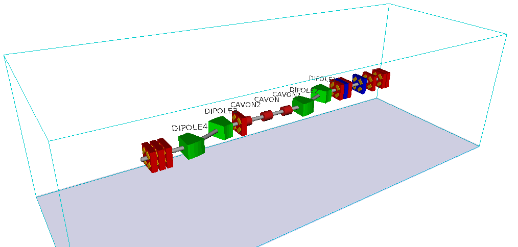

The problem I believe is that I am using RFDF element which the view3dgeometry (at least my understanding) does not take into account. I think it should be easy enough to add this given the clear structure of the program. I cross-checked this by changing my RFDF to RFCA and bingo it worked...
For completeness, I am attaching my param and flr files if you like to fix this. Also, typically in elegant we assume the cavity is zero-length (for assumptions to begin quick simulations), I don't know if view3dgeometry takes this into account when plotting.
