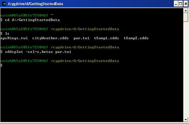

Post by michael_borland » 20 Apr 2010, 08:34
Yes, just type the name in the Unix shell. First, you need to navigate to the proper directory using the "cd" command. There are various unix tutorials on the web that you may want to look at. For example: http://www.ee.surrey.ac.uk/Teaching/Unix/unix1.html

Post by CCH » 22 Apr 2010, 04:10

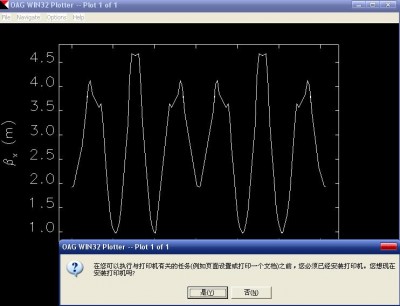

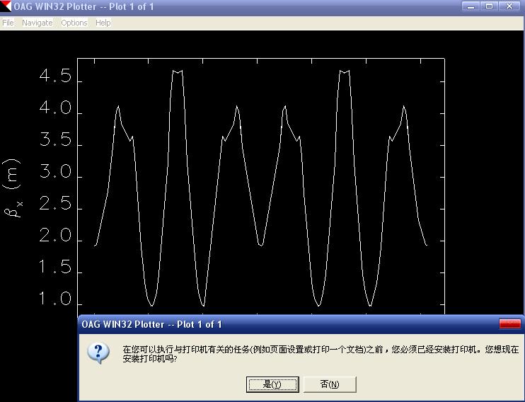

Thank you ! Now I can run these examples.But when I used the sddsplot,I got an error message.It read:Before you can print ,you must install a printer. The screen shots are shown in the following.

Post by soliday » 22 Apr 2010, 09:22
Try changing the default printer. sddsplot has to load the printer drivers and it has trouble with some printers.

Post by CCH » 22 Apr 2010, 21:27
Thank you! It works
