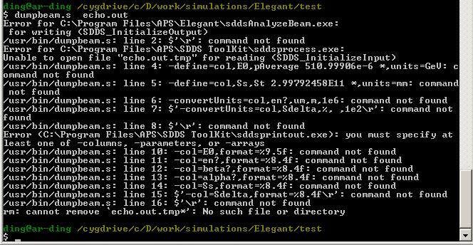

hello Bob,
I attached two files with the script and error message.
It seems the command was not recognized, but I can type to use in the cygwin terminal.

Re: sdds scripts not working in windows version
Well this is what I see when I open your script in xemacs:
sddsAnalyzeBeam $1 $1.tmp^M
^M
sddsprocess $1.tmp -noWarnings \^M
"-define=col,E0,pAverage 510.99906e-6 *,units=GeV" \^M
"-define=col,Ss,St 2.99792458E11 *,units=mm" \^M
"-convertUnits=col,en?,um,m,1e6" \^M
"-convertUnits=col,Sdelta,%, ,1e2"^M
^M
The ^M tell me that you have Windows line breaks in the file. This is what the script is seeing when it says "\r command not found". \r is a Windows line break. You can remove these by running a cygwin program called dos2unix.
Thanks a lot. works.
