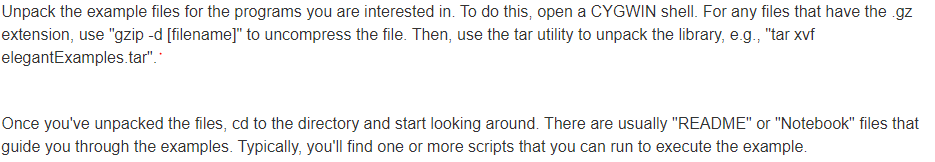

Re: Installing ELEGANT with CYGWIN
Post by fabioluneli » 09 Mar 2022, 22:10
Hello!
Actually i put the wrong title sorry. I am having problem with this step that is attached. I meant that cygwin isn't locating the elegant file that i downloaded. I have already tried to find the file using "ls" command, but only two files appear. Understood?
Thank you!

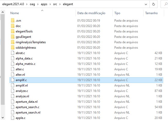

fabioluneli
Posts: 26
Joined: 10 Feb 2022, 08:08
Post by fabioluneli » 09 Mar 2022, 22:19
Just to complete information about the previous reply that i made. I have downloaded elegant software, and it appears like this (attached). This is ok right?
Thank you!

Post by soliday » 10 Mar 2022, 11:57
To get to c:\ inside of cygwin, you have to go to /cygdrive/c
Your download is probably in /cygdrive/c/Users/<username>/Downloads/
But you are looking at the source code here. I do not recommend compiling it yourself. You should instead download:
https://ops.aps.anl.gov/cgi-bin/oagLog4 ... nt-x64.msi
https://aka.ms/vs/16/release/vc_redist.x64.exe
Run both of these programs outside of cygwin.
After they are installed you can run elegant from inside cygwin. It should automatically be in your path:
$ which elegant
/cygdrive/c/Program Files/APS/Elegant x64/elegant
