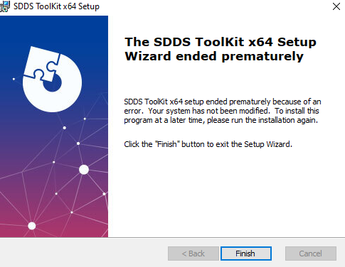

Here is the error that appears... It is attached.

soliday
Posts: 415
Joined: 28 May 2008, 09:15
Re: SDDS Installation
Post by soliday » 11 Feb 2022, 11:46
Perhaps it is an permission related problem. Try installing the software with an account that has administrator privileges.

Actually i haver already tried, i am using the main user.

I updated the packaging software to the newest version in case there was an issue they may have fixed. Let me know if you are able to install the version at the following link:
https://ops.aps.anl.gov/downloads/SDDS_ ... 4-test.msi

Hello, thank you! I have already solved SDDS problem! The problem was installing one partition over another.
